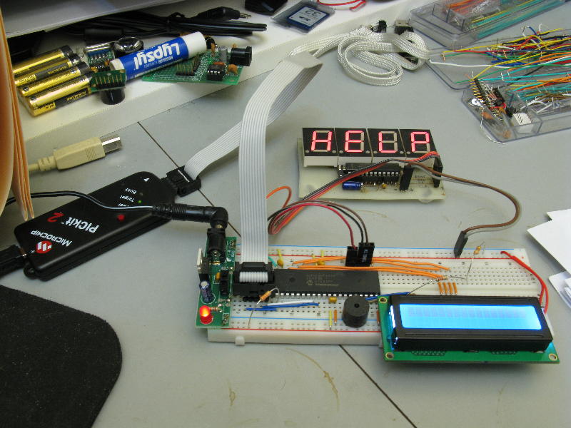

For instance, here's a homebuilt dev board connected to a breadboard with a ribbon cable so I can do temporary things without having to solder everything in. The dev board PIC is the brains, but the circuit being controlled is on the breadboard. The small ribbon is the ICSP cable for programming the 18F452 on the dev board.
In case you think I'm full of crap cuz I have different programmer than you, I also own an Inchworm+ and the Unicorn USB upgrade for it too. I just use the Junebug/PICkit2 more often these days.

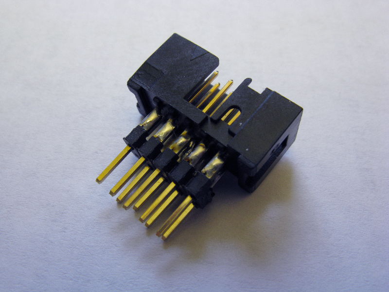

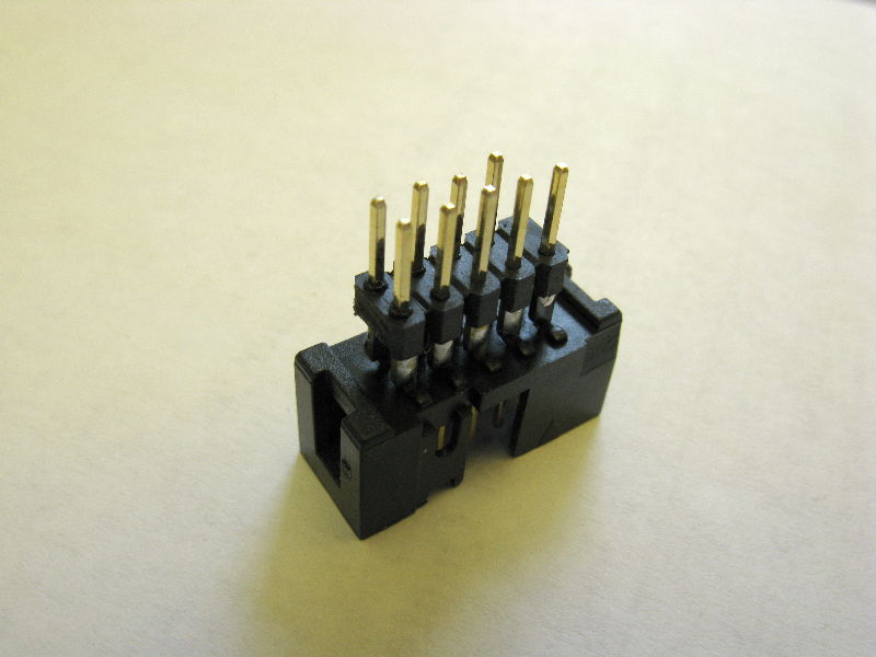

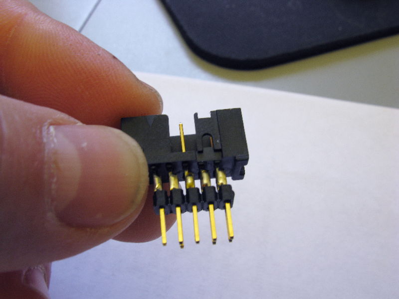

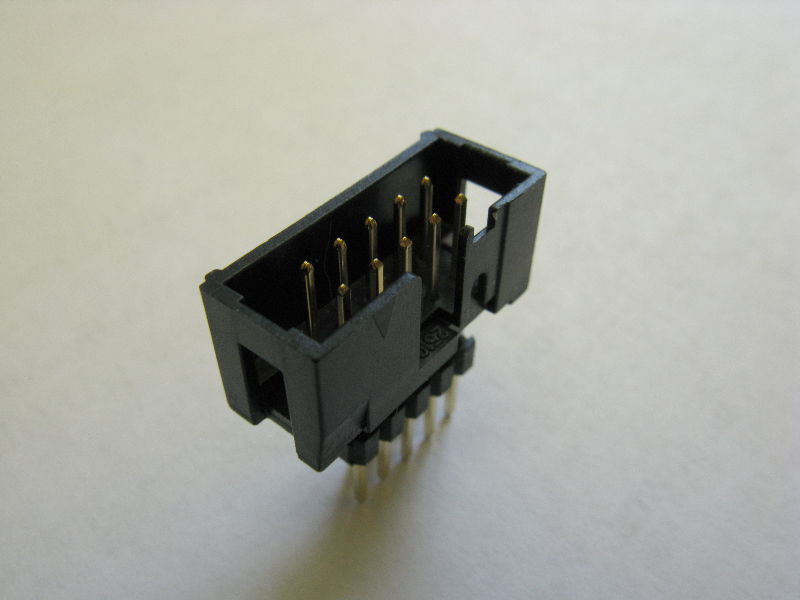

Build yourself one or more of these for connecting your ICSP cable to the breadboard. The male connectors are cheap and easily available. The reason the header is missing one pin is that it was a USB connector that was salvaged off an old computer mainboard. That pin isn't needed anyway so I didn't cut a new piece of header:
You can get free programming cables by ripping parts from ancient pre-pentium computers and assembling two old serial cables into one programming cable. Or you can buy them new from SparkFun or other company. Or just buy the connectors and build your own cables using ribbon from old floppy/IDE cables.

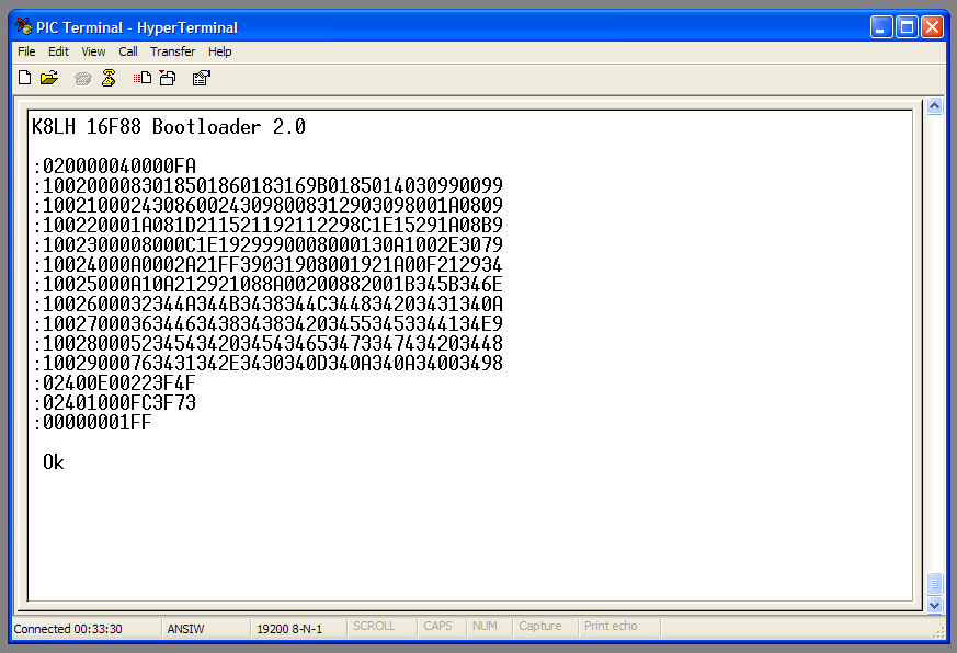

If you prefer having your Laptop, Programmer, and Project board all laid out in front of you during your development sessions, that's fine. There's nothing wrong with that. Myself, I find it faster and more convenient using just my Laptop and Project board (programmed with a serial bootloader) which also seems to be a bit more portable (I always carry my Laptop and my Project board may be small enough to fit in a shirt pocket). I also don't have to dedicate (sacrifice) my PIC ICSP pins or take up board space for an ICSP connector.
Bootloaders aren't for everybody and I haven't found one I really liked and so I write my own. Both 16F' and 18F' versions use less than 256 words of program memory. My bootloaders don't require a proprietary PC 'front end' but use Hyperterminal instead (which comes with the PC). I also use any existing pin that's connected to a switch or speaker or something like that as the bootloader 'trigger'. That is, if there's a switch connected to RC0 for example, the bootloader simply tests to see if that switch is pressed during "power up" or after a "reset" to 'trigger' the bootloader. This makes it extremely easy to get into and out of the bootloader during the development process. For example, I press and hold the switch connected to RC0 and press the "reset" push button to bring up the bootloader. I download the new hex file using Hyperterminal. Then I press "reset" again to restart the Project board with the newly downloaded program. The whole process takes only a few seconds.
Yes, you do need to modify your application programs to operate correctly with a bootloader. This is easy for assembly language programs but requires a little more work for C or BASIC programs;

< picture below of Hyperterminal screen after a program download and just before pressing "reset" on the Project board to start the new program>
