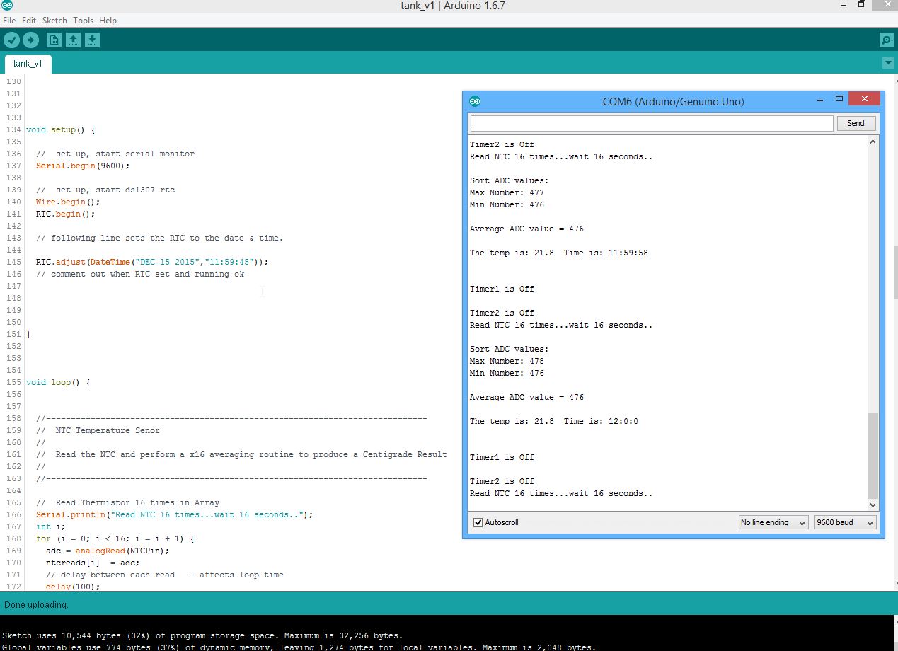

Its going to be tough learning micros without a good internet connection as you normally use it to download the chips IDE program, usually quiet large, and the chips datasheets and various tutorials.
Assume that US guy is offering you the AVR stuff for free, can he make up a dvd for you with the relavant datasheets and an IDE etc ?
As said before Assembly is a good way to learn the detail of the chips, but in doing so usually means buying the chips and programmer separately or an expensive development board, not that cheap and difficult if you have no easy supply lines.
I can hear the screams from others, but suggest you perhaps consider the Arduino boards like an Uno, which if bought as a clone are very cheap and all you need is a usb port /lead, it downloads your program code straight in to it and you can use its serial monitor on the PC to display things; as the pic belows shows, so you do not need to buy lcd straight away.
A breadboard and wire to connect up a few basic components like leds ,switches , themistors, optos can give hours of fun and learning.
Importantly it is not essential to have a full understanding of every bit and byte to get you going and its small IDE has many examples to guide you , plus masses of online help.
