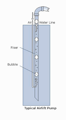

Compressed air is injected into the pipe in one to three second bursts with an interval long enough to let the resulting bubble to rise to the higher, output end of the pipe.
That does not say that the bubble has to travel all the way through and out of the pipe. Only higher, (towards the) output end of the pipe. That is my interpretation and all the illustrations I've found support this:
Anyway, Interesting technique. Could be easy to experiment in small scale at home.. I don't know why, but could be fun.
Yes, but why slow down the mass transfer with extra bubbles?

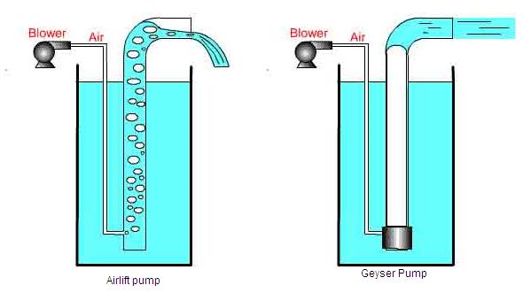

I looked at couple of papers and they all say that there is an optimal airflow for efficiency and optimal airflow for maximum capacity. The flow pattern also affects these optimal values. Not one paper said that best thing is to send one bubble at a time through the pipe. In fact it looks like that it is better to have lots of small bubbles traveling up the pipe.
http://digitalcommons.bucknell.edu/cgi/viewcontent.cgi?article=1027&context=honors_theses
Increasing the air flow rate results in increasing water flow rate up to a point, after which the water flow rate levels off or may even decrease with a further increase in air flow rate.
Generally speaking, the procedure is as it is described. You want to inject more bubbles. The onus is on you to show that would be valuable.
I'm just questioning the method of sending one bubble at a time.. the onus is on you to show that that even works, or is better than multiple bubbles.
I read the first paper I linked and based on that I doubt that sending one bubble can lift any water. Maybe if the bubble is large enough, but then the pump is more like a geyser pump.

jpanhalt, I just realized that we are talking about two different things here. AutoAnalyzer has nothing to do with Airlift pumps.. and yes, adding more bubbles to the AutoAnalyzer transfer tubing will slow the mass transfer, but I was not talking about AutoAnalyzer. I was talking about airlift pumps.

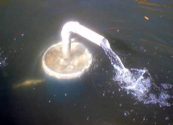

Over 10 years ago created non optimized airlifts using a continual supply of smaller bubbles.
I do think there are two different methods here. With the fine bubbles you are lowering the specific gravity of the the water in the column and the water around it pushed it up. Also used in foam fractioners. One problem is that as the foam moves up the column the bubbles combine into larger ones and lets the water fall while the air goes up.
The dredge is inserting a plug of air into the column and it rises lifting the water above and below it. I think
I may have misinterpreted this on reading it again I see the same thing. An interval between bubbles to let the first to near the top prior to creating another one.
