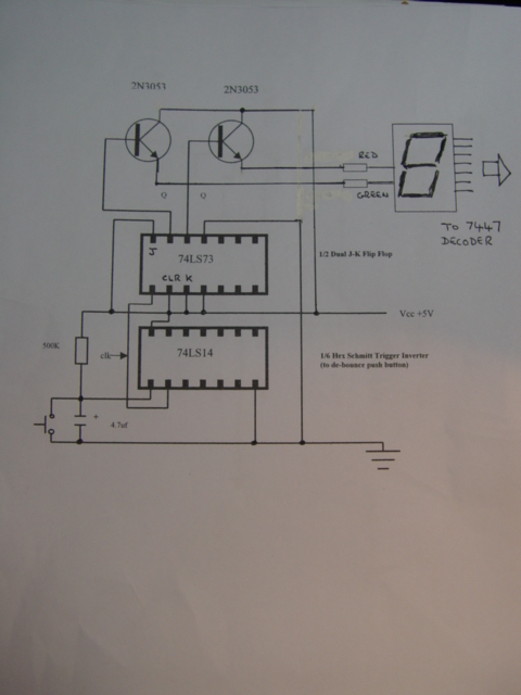

Nigel, thanks for the reply.
You're probably right but I've checked and can't see the problem unless it's the design itself. Anyway, I've (I hope) attached a jpg of the circuit so would be very grateful if you could take a look. Sorry for the poor quality.
Vcc is supplied from a 1A 7805 regulator.
Thanks again
Trevor
PS Sorry, I just realised there's a big mistake in the drawing. I've got the collectors wired to GND instead of Vcc. I'm getting old! I had them correct on the breadboard! I'll try and update it.

Old TTL logic ICs aren't designed to source much voltage or current when high. Maybe only 3V at a couple of milliamps. When an LED load tries to draw 10mA or more then the output of the logic IC sags. Your green LED probably needs about 3V at 10mA or more.
Use Cmos logic which swings the full supply voltage. It can drive an emitter-follower for more current very well.
If you insist on using old TTL logic, it can drive common anode LED displays fairly well. A 74xx IC can sink to ground 16mA. :lol:

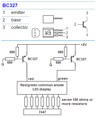

Hi Trevor,
I just realised that you are switching the colour of an entire 7-segment display, not just a 2-colour LED.
Then your existing TTL ICs can drive a PNP transistor for a high output voltage and current for the display.
Yes, Audio's circuit should work very well.
I had assumed (I should learn to read) that you were using CMOS.
Len

Hi Audioguru
I tried out your circuit suggestions and got the circuit working but the transistors only switch if I increase the external supply voltage from 12 to 14 volts.
I should explain that the on-board power supply is a 7805 regulator together with a couple of caps for smoothing. I'm powering it from a 3A bench power supply set to 12 volts (the circuit will eventually be run off a 12v dc motorcycle battery) and the measured output after the regulator is about 4.8volts.
Should I try reducing the 680 Ohm resistor between Q and transistor base to address this? I'll carry on fiddling around in the meantime.
Many thanks again for the help.
Trevor
audioguru said:
Hi Trevor,
Hi Trevor,
The circuit should work fine with your 4.8V supply. Anything more than 7V will exceed the absolute max voltage rating of the 74LS73.
When the output of the 74LS73 goes low to 0.5V or less. the base of the transistor will be pulled down to about 4.0V. The 680 series resistor will have at least 5.2mA through it and the transistor's base will get at least 4mA. With each segment of the display very bright at 30mA, seven of them draw 210mA. Therefore the transistor must have a current gain of 210/4 = 53. Its guaranteed minimum is about 60.
Typically, a BC327 will saturate at 0.25V with a 210mA load and 4mA of base current.
Maybe you have its emitter and collector pins reversed.
Maybe you have a weak BC327 transistor. General Semi sell them in batches of selected current gains and their BC327-40 has lots of gain. :lol:
