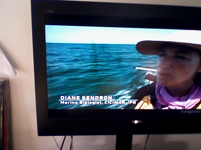

i have a 47in tv.it is a samsung and i bought it about 3 years ago and about 6 months ago it started with a small blmish at the left side of the screen.since that time the blmish has grown into a smugy sterak that is growing from the top of the screen going down the screen like a lighting strike. is this something that happenes in these type tv or have i bought a tv that allready worn its selfe out?if you have any thing you can offer please let me know.

` i have a lcd tv not plasama.i am not a smoker so that cant be the problem.i will give a better try at giveing all i know about the tv.as far as i know it is a sanyo 47in lcd flat screen hdtv.it has 3 video outs and 3 hdmi outs.i have a sony surond sound with 4 speekers hooked up as well as a samsung blu-ray player hooked up .i also have one of the hdmi outs hooked up to my computer.as fat as the streeks go they are not visable all the time.if the color in the seen is bright they are harder to see where as black and white they streek through half the screen i will try to get a pic and post if you need any ohter info please let me know and i will do my best to get it to you.i took a pic but u might not be ble to see much.i think that the more the tv is on the worse it gets.since i am disabled and stuck at home most of the day it gets bad later at nite and i am writeing this in the eirly afternoon.if i can get a better pic i will post asap. i have just taken a look at the pic i took and u can see the streeking i am talking about look at the mid part of the screen.
i would be happy to post a pic i took the pic and thought it uploaded guess not.if some one will send me a link to this sights aera that will alow me to do the uoload i would do it right away.i will also check after i post this maby i can find it in the sight?i looked but have so far been unable to figure it out.thanks for the look so far and if there is any other info u might need then just let me know and i will send it right away.
the pic u ask for
i hope this will post the pic u have ask for.the streeking should be fairly easy to see if not i will take another one.the phone i have does not have the best camera i will have to bresk out the other camersa if this does not work for u.

Look at the back of your monitor, there are only vents in the middle of the back surface. Now look at the back of a LCD TV, the whole back is full of vents. The vents on the top edge are open directly to the screen and backlight. there is about a 1/16'' gap between them that lets smoke or dust or what ever in there.
The dust/smoke gets on the tubes of the backlight and causes the shadows.
