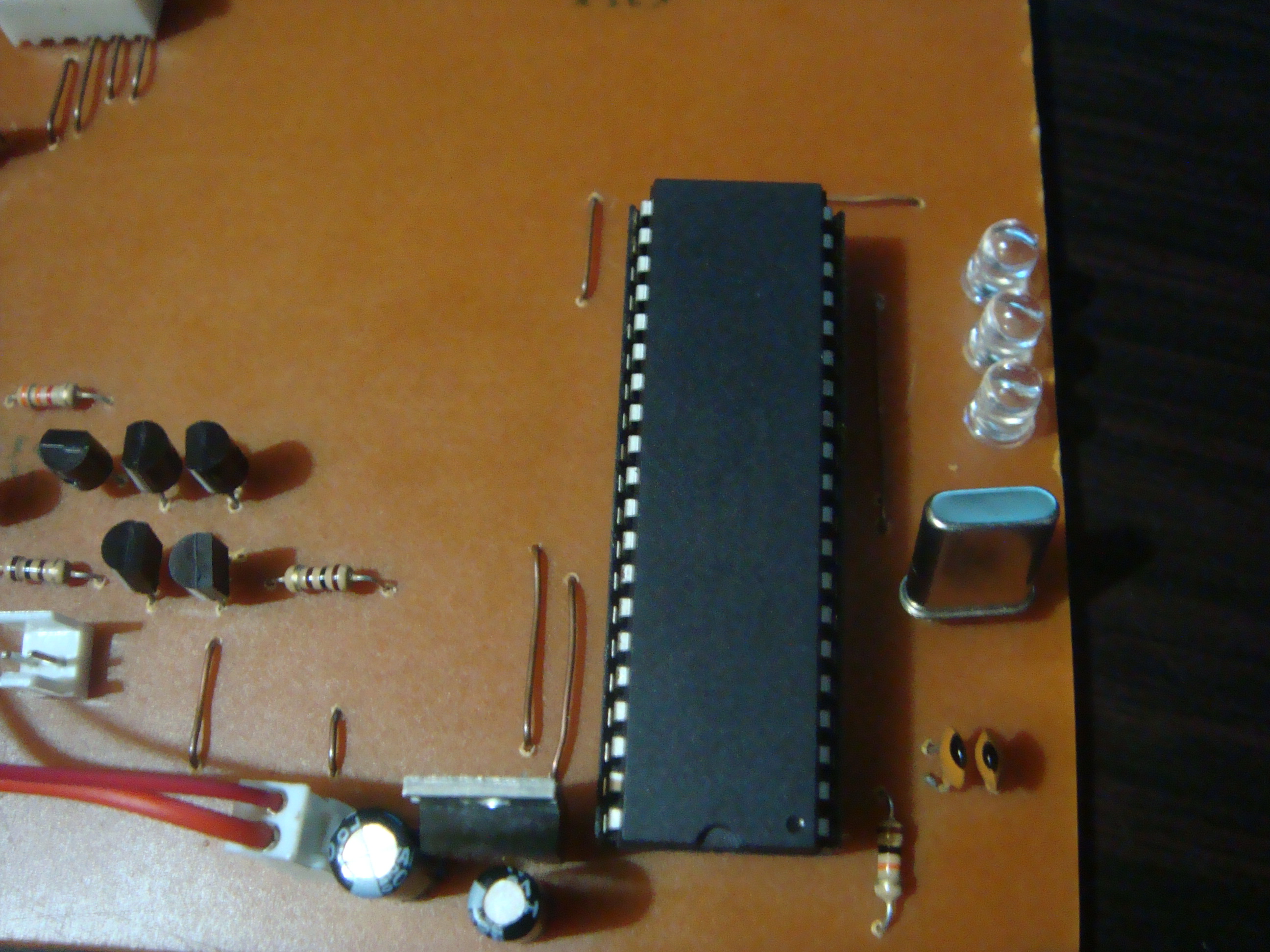

I already designed alot of PCBs and this is my first time to encounter this problem. Flashing LEDs on my newly designed PCB isn't working. What's strange is that, when I touch pin 13 of the PIC or even the copper path going to it makes the PIC work properly, but when I'm not touching it by my finger, the PIC wont make the LEDs flash.
PCB connections:
pin 1 - 10k ohms to Vcc
pin 13 & 14 - 4mhz xt osc
pin 32 - vcc
pin 31 - gnd
Can you help me?
EDIT: I tried desoldering the 4mhz XT Osc from the PCB and made a touch of my finger on pin 13, the LEDs go flash.

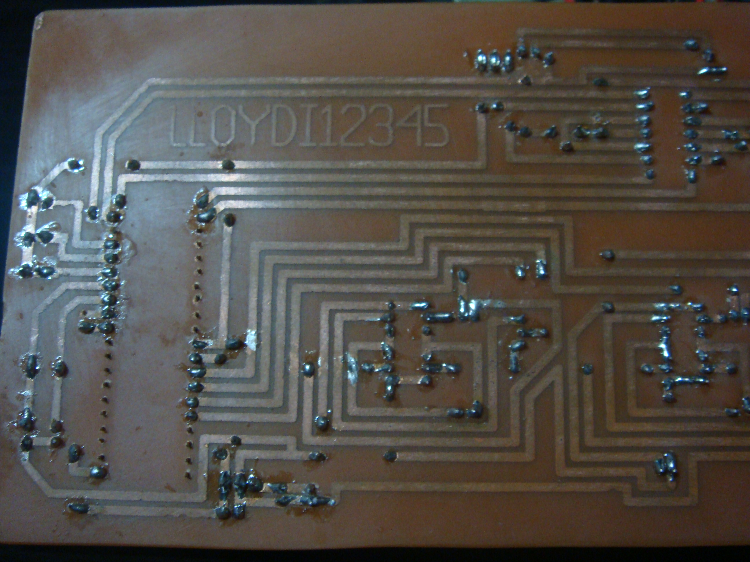

The image below is the shot taken when the Vcc and Gnd pins are not yet hooked up to its pair.

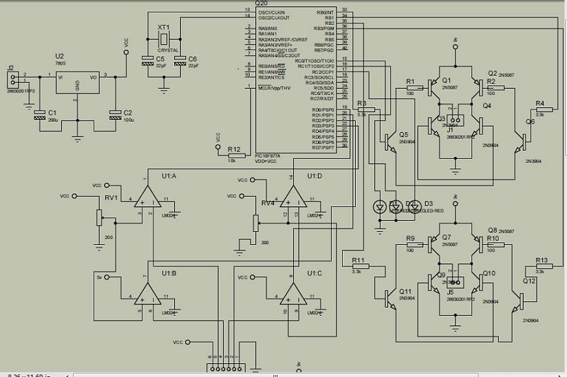

I already have capacitors at the end of each XT Oscillator's pin. On my PCB I don't have 0.1uF cap hooked on Vcc and Gnd for my PIC. Will this help a lot if I'll drill this one and solder it?
Put a 104 from vdd to gnd and if that don't work clip a gnd on the crystal
I got hold of some crystals that wouldn't work if the case wasn't grounded
Your osc should be set to _HS_OSC
:D Oh, I've changed the code already.. Too bad I can't make the PCB work since the solder part now is messed up because of troubleshooting alot, so I'm abandoning my design and work for a new PCB design. Thanks though for the help really.
And don't forget the 0.1uF caps near as possible to the PIC power pins. Two would be nice, one on each side. You're also missing resistors on the LEDs. Your H-Bridge is missing clamp diodes (running motors I guess). A SN754410 would be an excellent choice IMO and can be speed controlled with the CCPx (PWM) outputs.
Added bonus use a 16F887 instead and you can skip the crystal. Or since you're programming in assembler take a peek at an 18F4620 or the like, none of that pesky bank switching and the 4620 is very pin similar to the 877A. Plus it's supported by Swordfish BASIC (really nice compiler with a free SE version)
uhm, my bad on our place there's no SN754410. On my first design I didn't used protection diodes and it worked well. Then I made this second time and failed on the timing circuitry. So for the 3rd time can I still not use again any protection diodes on my Hbridge DC motor transistors. I've seen on many toys that there were no protection diodes on their PCB. I would like to know your opinion whether installing it or not.
