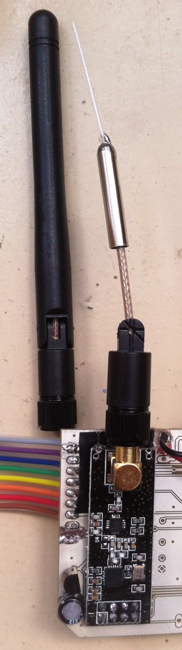

Here's a picture of my circuit. I took the plastic cover off the antenna to see what was inside. A similar antenna is shown next to the circuit.
I assume the thin insulated wire is the 1/4 wave part that emits the RF radiation, and the shiny metal shield below it provides some kind of ground plane. If this is the case, should the ground plane of the PCB also be critical to the circuit's operation?
The receiving antenna is the same.

That form of antenna is what is known as a sleeved dipole.
The thin wire is the quarter wave vertical element, and the metal cylinder is effectively a ground plane folded around the feeder coax cable
I'm a little confused, is my antenna a quarter-wave monopole in which the sleeve serves as a ground plane, or a half-wave dipole where the sleeve is one of the poles?
I found some discussion of similar-looking aerials here, in which the sleeve is described as a 'radiator'. It included the following, which could explain my experience with bending the aerial:
"the coax feedline really needs to extend in line with antenna for at least 1.5 to 2 wavelengths, to prevent distortion of the radiation pattern"

paulr asked: I'm a little confused, is my antenna a quarter-wave monopole in which the sleeve serves as a ground plane, or a half-wave dipole where the sleeve is one of the poles?
The quickest way to find this out is to measure the length of the thin wire on top of the antenna. At 2.4 GHz, one wavelength = 12.49 cms. So half-wavelength = 6.245 cms & quarter-wavelength = 3.12 cms. The problem with transmission range is very likely antenna related (I'm inclined to agree with MikeMI in post #8, since increased range when the body is in close proximity to the antenna is strongly suggestive of inadequate ground plane). Rather than belabouring this point to its ultimate conclusion, here are some links on improving the antenna to increase range:

Thanks for the extra info, I'll be taking a good look. In answer to your point ramuna, the insulated wire part of the antenna is 1/4 wavelength; the sleeve as you can see is slightly shorter than that.
