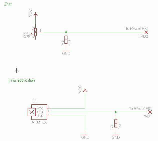

For testing I have a pot of 4K7 to VCC, other pin is not connected. On the input there is also a 4K7 pull down.
For the final solution I will have a pull down of 4k7 and the output of a hall sensor A1321
What would be the minimum delay between the read outs? and how should I calculate them?
Is it correct to do it like this? and should I add a condensator to eliminate interference between different analogue inputs?

With 4.7K you're pretty well OK - the two 4.7K's give a source of half of that figure - 2.35K - which is close enough.
There's a sample and hold capacitor (condensor disappeared decades ago) inside the chip, it the charge/discharge time of that which makes the channel switching time dependent.
Is the scheme of the final application, the one with the A1321 OK?
Would I need any condensator to eliminate interference between different analogue inputs?
