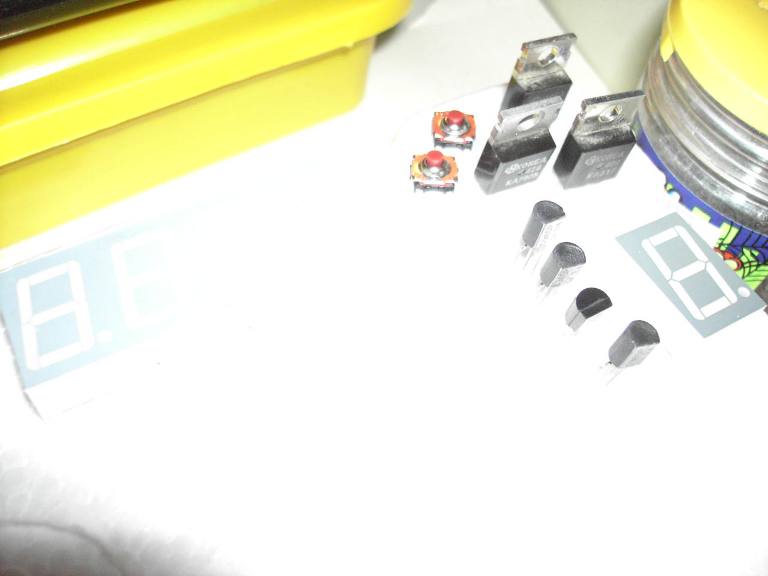

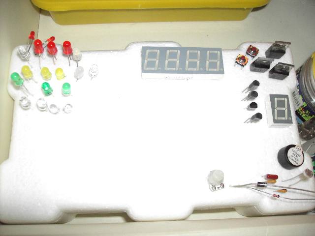

So, I recently started using a piece of thrmocole (coal?) to keep/attach my small electronic components like LED's, transistors, switches, caps, Ic's etc. Its easy to place them and easy to remove, its light and can be placed even upside down sometimes!! I am thinking of sticking it on my wall near the table:)

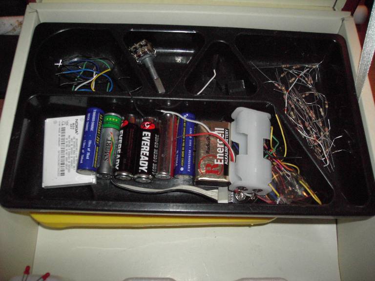

And the black one I mainly use as a store for small connector wires, which get so rare and lost sometimes.
Here is a pic, what do you think? I didnt know if it was safe in terms of static. tell me if its ok. And how do you all store? Send in pics if possible :)

i dont worry about static safeness storing my parts and pieces

Using normal polystyrene foam to store semiconductors in is a bad idea due to the potential ESD hazards. Granted most stuff including red/orange/yellow/yellowish green LEDs, doides bjts, jugfets, LM317s and TTL is pretty but CMOS componants and blue/white/voilet/UV LEDs can be pretty sensitive and easilly destroyed. Use conductive foam or make your polystyrene conductive by wrapping it in aluminium foil.
I use fishing tackel boxes too and they can cause ESD problems too so I keep the sensitive componants pushed into conductive foam blocks; if you don't have any of these then line the compartments with aluminium foil.
