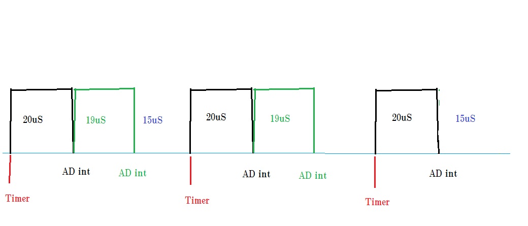

I am working maintaining a code for a STM8, that involves timers. The clock is set at 16MHz, ergo 0.0625uS. The settings of the timer are ARRH=0x03 and ARRL=0x20 therefore(0x0320=800) it resets at 800( 50uS). PSCR is set to 0 so the timer has the same freq as the micro
Anyway, I checked with an oscilloscope and it does not give good readings. The timer interrupt is called at
56us , 54uS, 54uS, 52uS, 52uS, 52us, 38us(!!!), 42us(?), 50us, 50us....
curiously summed up it gives 500uS so it does count as 10 times 50uS
The first 8 times at the timer interrupt some AD conversion is happening so I think that the AD finished interrupt is being called in between too.
I disable the AD conversions and the timer interrupt is called at exactly 50uS, so I am concluding that the AD conversion is what is affecting the timing of the timer. Any comments on this??

Assume the ADC interrupt is firing around the same time as the timer interrupt.. Now the ADC just happens first.. BUT!!!! the timer hits 50us 1us after... The ADC is serviced.. the timer interrupt waits and then will be serviced as soon as the ADC has been completed some time after REMEMBER the overflow has already flagged and the timer is counting again... Once the timer ISR is serviced.. there will be 50us - wait time so the next ISR for the timer will seem to come earlier... when in fact the overflow flag will be set at exactly the same time..
If you can prioritize... Make the timer a higher priority than the ADC..

Thanks for the answers. I further investigate and I found this:
As you can see the red Timer label is where the timer gets called. This timer starts a AD conversion and the black AD int is where the AD conversion finishes. It takes 20uS. In the first cases, the same AD interrupt service function calls an AD again which takes another 19uS and finishes in the green label. after that the AD interruption is disabled.
Now you see that 20uS+19uS= 39uS so there is plenty of time for the timer to tick at 50uS again but for some reason there is always a gap of 15uS until the next timer call. That makes it the 50uS timer to tick at approx 54uS
on the other hand when the AD service (in black) does not call another conversion there still is a 15uS gap which explains why the 50uS timer "self correct" and calls at 35~36uS.
I wonder why this is happening. Apparently there is no superposing of interruption calls
