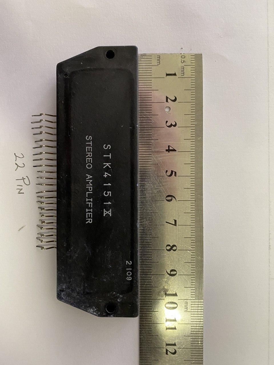

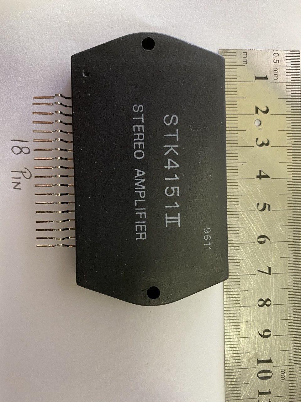

Hi There , I have a old (Sentimental) Amp with the stereo amplifier STK4151 X (22Pin) which has gone faulty , I now want to replace it with a STK4151 II (18 Pin).
Where can I search for the PINOUT configuration of these components , or has someone done this exercise before who can give me some guidance ?

Depending on the manufacturer of the amplifer there 'may' even be a manufacturers sheet on replacing the module with a later repair 'kit', Kenwood commonly did that. However, it's not usually that trivial a replacement - think fitting the module upside down, wiring each pin by hand, and adding various components - the kits usually came with a small PCB that held the extra components.

having looked through this: https://pdf1.alldatasheet.com/datasheet-pdf/view/116247/ETC1/STK4151X.html on pages 10 and 16 you will see that to match the pinouts, you need to leave the first two and last two holes on the original board empty... if the board has ceramic caps connected to the now empty pins, you will want to test the amp carefully with the "light bulb test" (connecting a 60-75W INCANDESCENT bulb in place of the main AC line fuse) and turning the amp on. if the bulb lights up and stays at medium or high brightness, check the amp for oscillation with an oscope. if the bulb goes dim, everything should be ok, disconnect the bulb and put the fuse back in... the light bulb acts as a nonlinear current limiter to keep things from frying if there's a problem. even if those caps aren't there, it's still a good idea to power up the first time with a bulb limiter.
