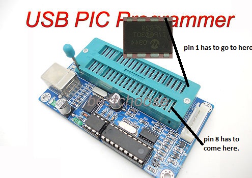

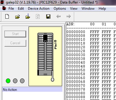

yessss 12f629 i was trying to programme with my galep i coudnt succes like you later i looked to pic of programmer that how i have to put it on zif socket.. 12f629 all diffrent than normal 8pin eproms you have to put invert !!!! :)) Really . check to photo. waiting your answer worked or not..
this is my programmer.. your supposed to be same or almost same. nothing lose for trying :)
