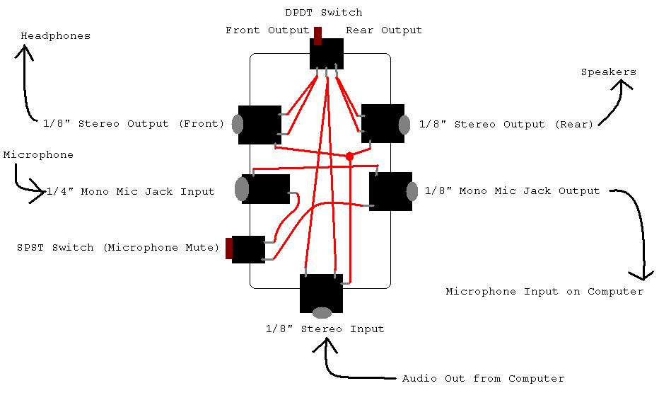

I've made an audio switch for my computer, so I can switch between my headphones and the computer speakers. It is working great, and in stereo sound thanks to Dean's recommendation for using a DPDT switch, but I was wondering if there is anything I can do to improve the sound quality.
Please see attached image.

The speakers and headphones are mono, not stereo because the switch is a SPDT, not a DPDT. The input channels are shorted together which might cause distortion when the channels "fight" each other.
Describe what is wrong with the sound quality.
The switch is a DPDT switch with 6 pins. The audio is in stereo, I've tested it. I just want to know if there is a more hi-fi way of doing this. Is there anything I can improve?
Edit: I realize that in my picture, the way the wires are connected, it looks like 3 pins. There are 6, and it's connected for stereo sound.
As the audio signal for each channel travels from wire to plug to jack to wire to switch to wire to jack to plug to the headphones or speaker, is the quality of the audio signal any less? Can you measure sound quality with a multimeter?
Your schematic shows the channels shorted together on a single pole switch so I mentioned it.
Short wires cannot affect line level sound quality.
A heavy duty switch with tarnished silver contacts might.
I always use gold plated contects for switching line level and low level audio.
They cost the same because the gold plating is thin.
A multimeter cannot measure sound quality.
Ok, so if I were an audiophile, the only thing I would do differently would be use a switch with gold-plated contacts?
Gold plated contacts are perfect for switching line level and low level audio.

Line level is 150mV to 750mV from a CD player or MP3 player into 10k ohms which is a low current.
Low level is a few mV from a phonograph or microphone.
They are not the many volts and many amps from the output of a power amplifier to a speaker. Gold contacts can not be used to switch speakers unless the switching is done when the speaker is silent without any current.
