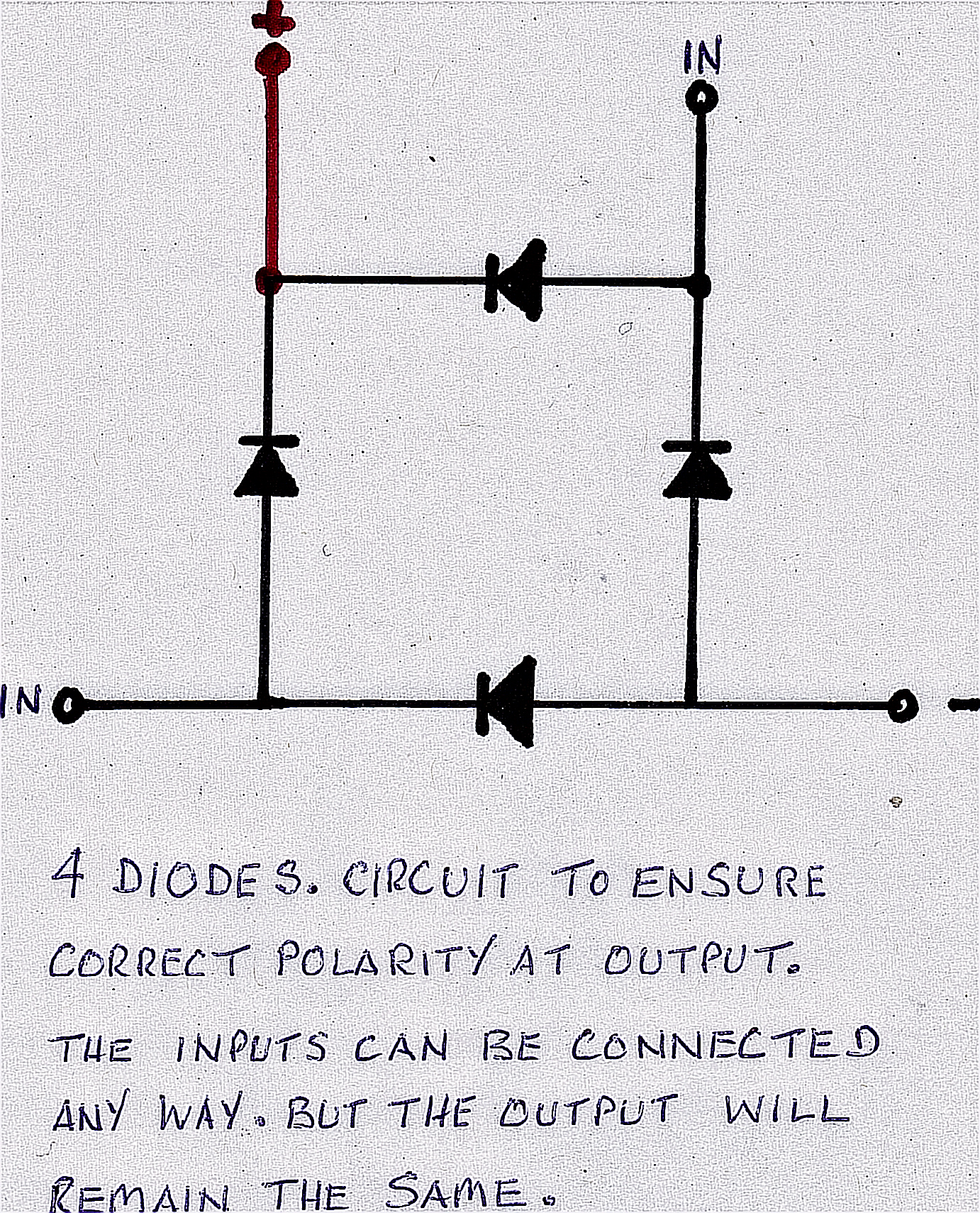

I am very interested in making this amplifier,and will contact you later re-this project.Having read your posts I feel that you could give me some usefull info,
at the moment I am running some low voltage,low ampage applications,MP3 players
for example.And I need a circuit which will ensure the correct polarity to the units
regardless of which input is connected to,this to prevent accidently connecting wrongly
kind regards sw
Polarity
Hi SW, O.K. It's easy,you just need 4 diodes(4004 will do,you can probably salvage some from any old circuit) and a small piece of circuit board.
Connect them up as shown in the attachment.It does not matter which is connected to the input of the circuit,the out put will allways remain
the same. glad to help.Terry

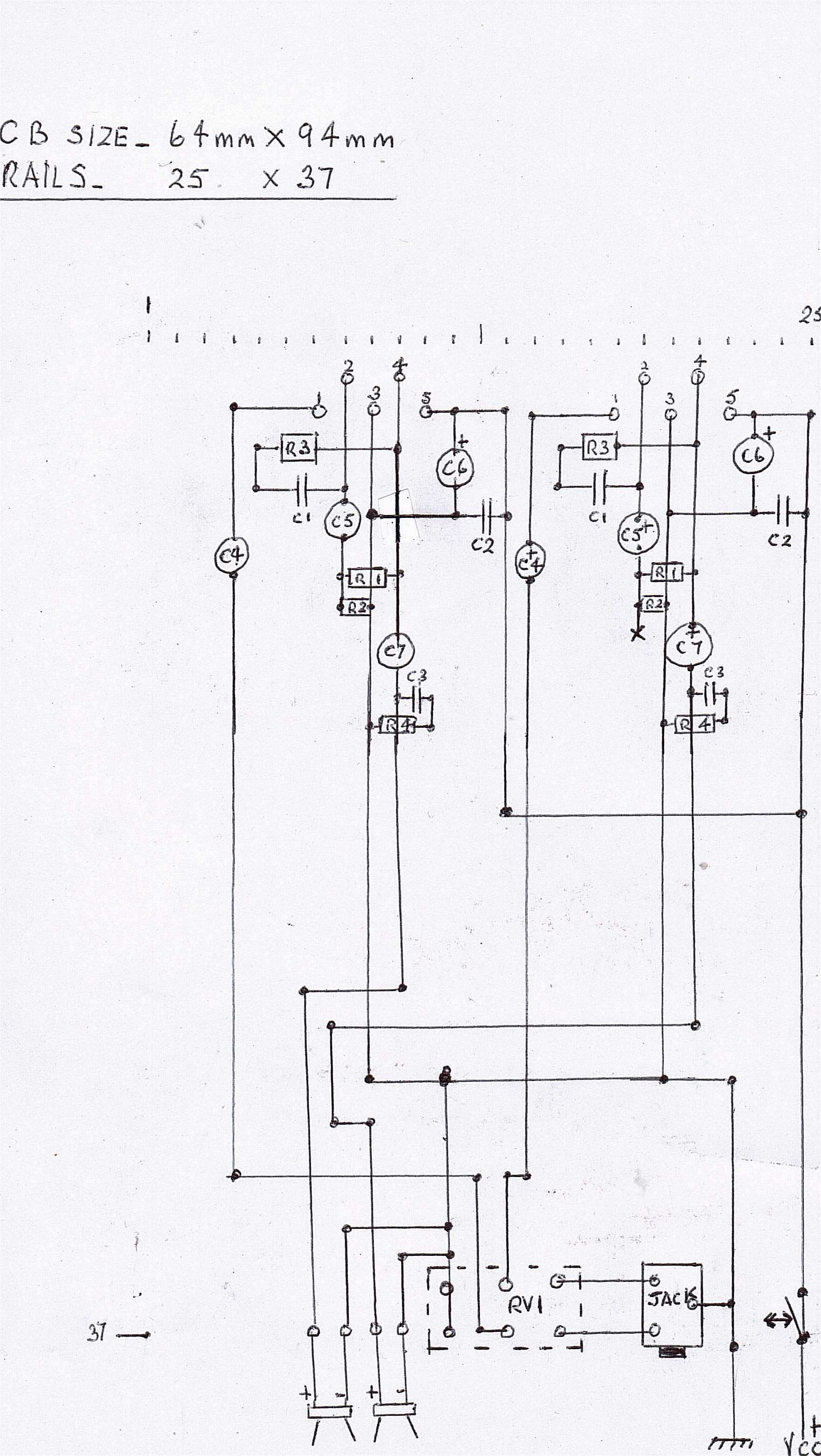

Hi tblo,I've made the little circuit using the 4 diodes,and it works PERFECT.So now I'm
ready to build your Amp.I have all the components,and would like to install them on a
piece of strip board that I have,it's 64mmX94mm,with 25x37 rails,can you suggest a layout to populate them onto this cb? Thanks for your quick responses, SW
Amplifier
Hi Sheila's wheels,glad to hear you've had some success.O.K.You can get
them on the strip board,with plenty of room,I've sent a suggestion,which you can modify if need be.you can space them out to suit your soldering skills,All jumpers to be on the top of the board,and "break" the rails where neccessary.As you will see it's 2 mono amps,giving 2 seperate channels.The two C6 Caps could be replaced by one 2200uF X35V,if you want,but you will
have to modify the jumpers.Any more help? let me know. Good luck Terry.

The diodes reduce the supply voltage to the TDA2003 amplifier so the output is only 3W into 4 ohms instead of 4W.
If the speaker is 8 ohms then the power with a 13.2V battery and the diodes is only 1.6W.

Thanks for the quick reply and info.it's the best I've had from anyone,it explains in terms that I can easily understand,without confusing me with too much technical data.
will let you know how I progress,SW;
