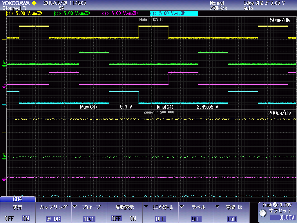

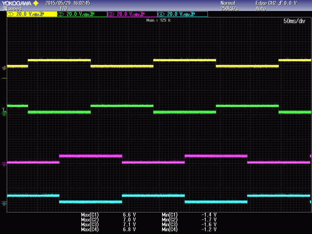

This is the signal from the microcontroller (wave drive)
As you can see, the signals seem to be ok and in the right sequence

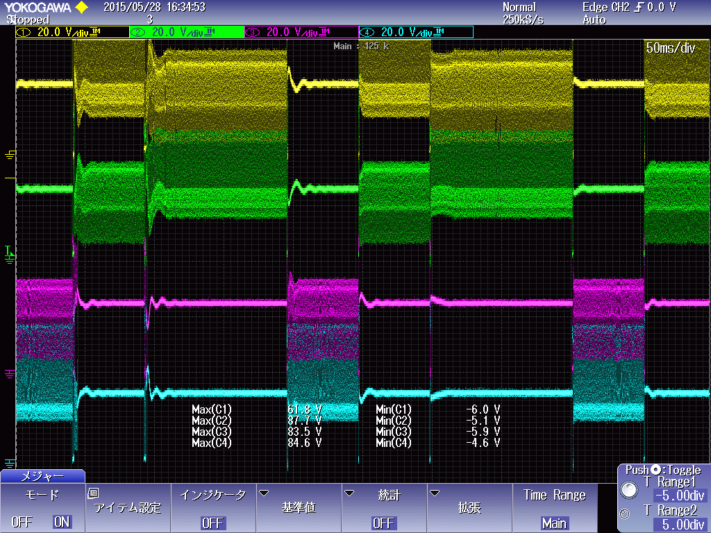

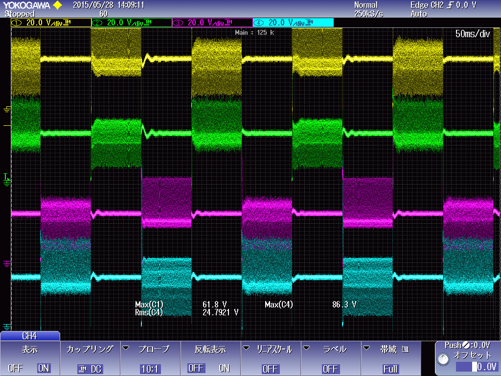

Now this is the signals that are going to the motor coils:
I don't know. Something seems fishy:confused:...
As you can see: for example when I activate B (A, ~A, and ~B=0) I got the following
Output:
A: 21.8V~25V (almost just 24V)
~A: 22V~26V (almost just 24V)
B: Huge changes(flickering) between 2.4V to 34.2V
~B: Huge changes (flickering) between 13.2V and 50.8V
Questions:
1) What are the supposed correct values that the output should have. I mean they are just transistors right? (see again schematic on page 4 of the datasheet)
2) that flickering signal. Is that because of the PWM the SLA7024M produce?
3) is 50V (or more) being applied to the coils? is that safe for a motor ranked 5.8V and to be used with 24V??
I would appreciate very much any comment, advice, or any help you could give me. Thanks in advance

Yes, if you're following the datasheet. What is your Vref? It should be <2V
Output:
When you activate B, the B output will switch between Vref and open circuit. The B and ~B are magnetically coupled (like a transformer), and that's why you see the negative of the B output at the ~B output (shifted by the 24V that they're both connected to). During this time the A and ~A outputs are not being driven.
1) What you're getting looks alright, except your Vref may be too high (it should be <2V). The outputs are transistors, but there is a switch-mode controller regulating the average current through each output (you can think of it as PWM, if you find that helpful).
2) The 'flickering' is due to the 'PWM' drive signal.
3) You are applying 24V to the coils. The 48V you see on ~B when B is activated is because of the magnetic coupling between the two coils but it has no current flowing. The IC you are using can have up to 100V on its outputs, so you are well within its limits (even the peak 61.8V reported by the DSO is well within the allowed limit).
So it all looks good to me, but check your Vref and sense resistor (it may just be that the DSO display timescale not zoomed in enough).

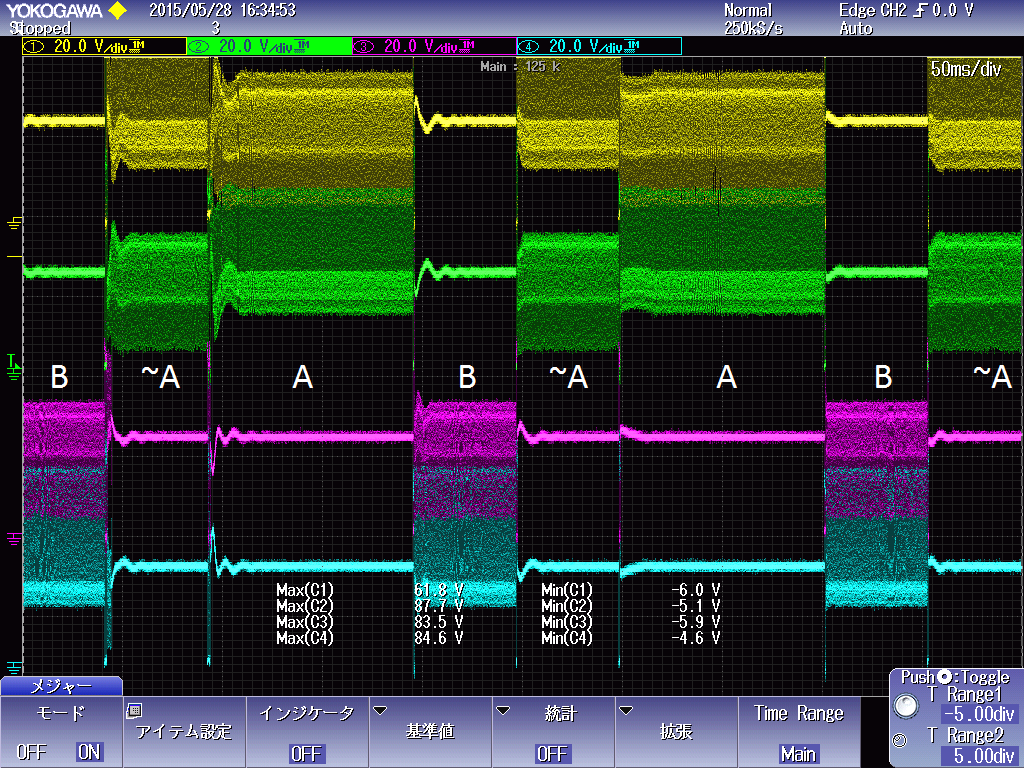

Thank you very much for your reply. I will check the Vref as you indicated, today.
After I wrote the post, I tried with full stepping in which not only A or B are activated but say AB or A~B. The results were not good at all. There was no correlation between the inputs and outputs, and sometimes the outputs were different for the same input. The motion of the motor was not consistent.
I will let a graph speak for itself:
You can see that A and ~A are almost always activated. Also B(violet) gets activated sometimes and ~B never. I noticed that in any case only one coil seems to be getting activated... I am lost at what could be the possible causes of this behavior...

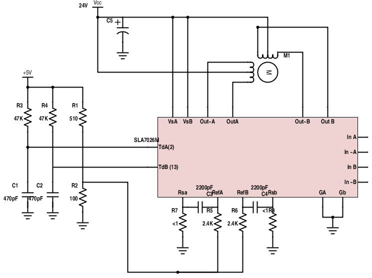

How have you wired it up? Which pin is your A input, ~A input, B input, ~B input? The IC you are using has two distinct halves; you cannot just treat the IC as four unique drivers.
My schematics are the same as indicated in the datasheet
for C5 I used a huge 1000μF 50V. I changed R2 from 100 to 82 to limit the current to 0.7A.
I never understood what for the RC circuit is for. (I understand voltage dividers so I could modify the values of R2 but since I dont understand RC I just used what it was written) For the sensing resistors I used 1 ohm.
side question: Can a bad soldering be also a possible cause??
You have shown an output that would correspond to a repeated sequence of {B, ~A, A}.
Are you feeding the correct signals into the driver IC? Have you connected all pins of the IC (including both GND, etc.) to something? The two halves of the IC should be independent, according to the datasheet, so if you set A and B inputs to high, the A and B outputs should activate simultaneously. Note that setting e.g. A and ~A high will result in no output.
You mention the RC circuit; there are two per driver. In the case of the one on the delay pin, it sets the amount of time that the output will remain off, even after the output current has dropped below the lower threshold. The other RC made up of the 2k4 resistor and 2n2 capacitor form a low-pass filter of the output current, which will slow the response, but will also reduce false triggering caused by high-frequency noise.
Re your soldering: if you have dry joints, you may have high resistance/impedance connections that will not handle moderate currents properly. Also, if your routing and grounding methods are extremely poor, then you may get other issues with the input signals (you'd probably have to try to wire it badly though). If you decrease the output current to 50mA or so, you may be able to see the waveforms that you're after. If this is the case, you have bad routing or solder joints. If not, then perhaps your signals are incorrect.
What do you see on your DSO when you set A and B inputs high, and others low (you could do this manually, without the microcontroller)? Repeat for ~A and B. Repeat for ~A and ~B.

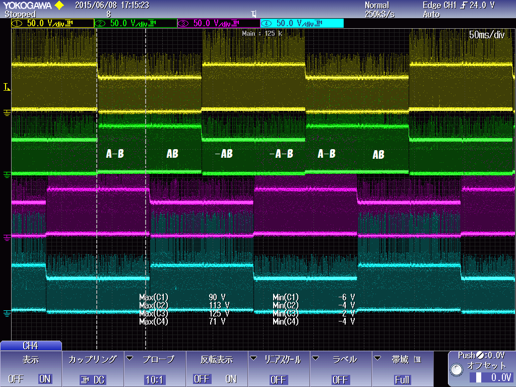

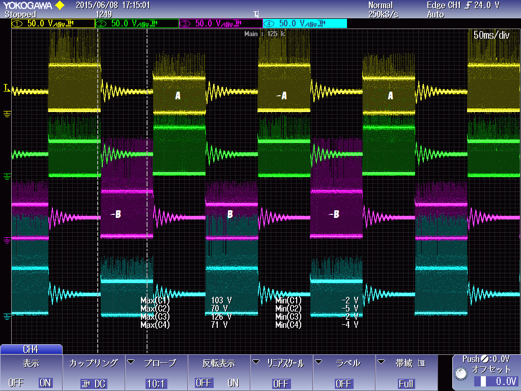

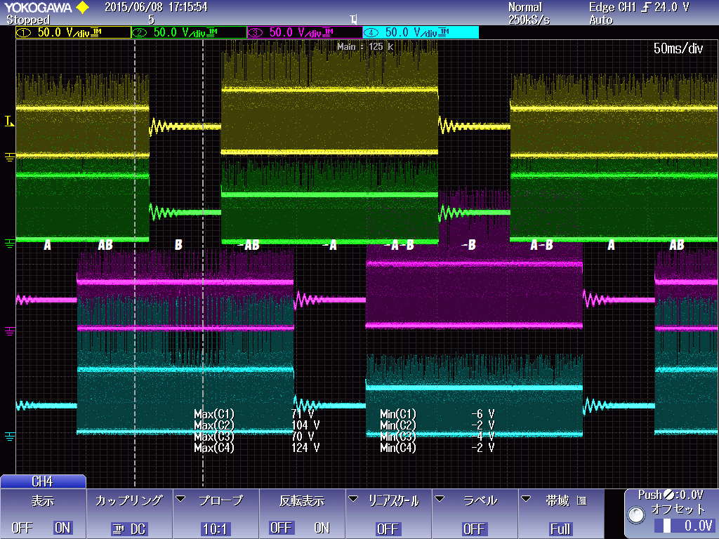

I have a confession to make. I have made almost all the circuitry of 5V (RC, voltage divider, IC) on a breadboard and then connect it with cables to a soldered perfboard with the SLA7024M and the 24V power in it. Somewhere (dont remember where) I read that the sensor circuit and stuff should be made very close to the SAL7024M. Can this be a possible reason??
Right now I am building a soldered board with almost all circuitry (maybe I ll leave the PIC to a breadboard) soldered to the perfboard and employing a SLA7026M. I am hoping I can get better results with it.
I have to report what it seems to be good news :) The motor started moving nicely.
I suspect then the problem was that I was doing the circuitry on a breadboard and connect it to the board with the SLA7024.
This time I used a SLA7026M with the sensor, reference and time delay circuitry soldered to the board. The only thing I left out was:
-> The outputs: connected with a cable to the motors
-> The power: connected with cables to the 5V and 24V power.
-> The inputs: connected with a cable to a breadboard with only the PIC 18F2550 in it.(and a resistor and capacitor to make the PIC work)

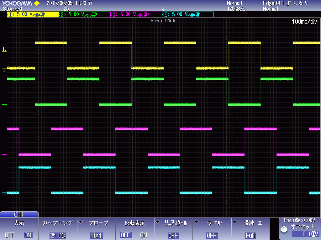

Now can someone (maybe you dougy83 :rolleyes:) please check my results?
The inputs coming from the PIC:

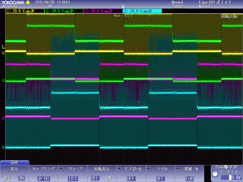

The outputs coming from the SLA7026M and going to the coils
What do you guys think? Am I doing it right? (Full step)
Next I am going to try half step to see if it works and then maybe solder the PIC to the board as well.
Thanks again!
Well, it sounds like you found the cause of the problem and when you removed the breadboard. The inputs from the PIC look good to me. The output is not very clear to me - perhaps you could change the scale (alternately, if you replace each motor coil with a 10k resistor, you'll see a clean waveform at the outputs, which should simply be the inverted signal of the input).

I ve noticed that the Motor gets a little hot. Is this normal or am I applying too much current?
(Osciloscope pics follow)
Wave drive:
Full Step (2-Phase)
Half-Step(2-1-2)
Another thing I noticed was that half step is slower than full step and wave drive..! (I thought the angle was the one that was going to vary but no, it was the speed)
Hello to Kyoto,
If the clock rate is the same then half stepping will take twice as long to complete one revolution. That's just because it takes two times as many clocks to get all the way around.
The film, "Lost In Translation", was filmed partly in Kyoto.
Yes, it's normal for the stepper motors to run warm.

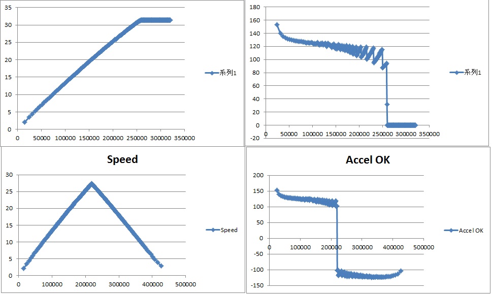

I reprogrammed my stepper motor control. This time it uses timers, etc. I solved the problem of stopping the motor like this: When I deactivate the timer the motor stops. When I activate the timer (well it really is a ticker) it repeatedly calls its sequence.
I have done quite a lot of work. I incorporated not only speed but also acceleration and deceleration. Tested it and for example it gives something like:
But I want to test it profusely.
One thing I notice (and it is important for my later question) Whenever I log delays (like the above graph) the stepper gets slower. I suppose it is obvious. Without logging it goes to its original speed.
So to test it further, I did the following:
  • Set the speed to 300 rpm
  • NO acceleration
  • move to position -600 (3 revolutions counterclockwise)
  • when stopped
  • move to position -300 (one and a half clockwise)
  • repeat
And it failed to move! The motor just got stucked.
