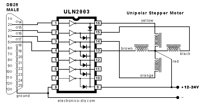

At the moment, I am using a mimusi stepper motor which contains five wires: red, black, orange, brown and yellow.
So far, I use the sequence: 0x01,0x02,0x04,0x08 at 12 times in order to complete one revolution with my AVR chip. It works well then I tried to reverse the direction and to my surprise, it still goes in the same direction instead of going backward.
Forward
Pin 16 of ULN2003 - Yellow - 0x01
Pin 15 of ULN2003 - Orange - 0x02
Pin 14 of ULN2003 - Brown - 0x04
Pin 16 of ULN2003 - Black - 0x08
Backward
Pin 16 of ULN2003 - Yellow - 0x08
Pin 15 of ULN2003 - Orange - 0x04
Pin 14 of ULN2003 - Brown - 0x02
Pin 16 of ULN2003 - Black - 0x01
I could not understand why. Any suggestion?

Pin 16 used for both yellow & black wires?
Which is the common wire and how is it connected?

I'm using the ULN2003 just for software testing I know it will not handle the load on a CNC.

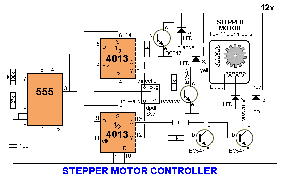

Here is a stepper motor controller circuit to help you test your motor. It will produce forward/reverse and determine the maximum rpm.
