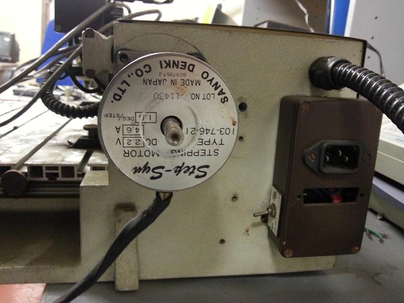

I have driven stepper motors before, so bringing the old engraver down to refurbish ( I want to make a PCB mill )
Here's the beast.... There are two Sanyo Denki motors rated at 4.6A per phase but only 2.2v ... Is there drivers out there for 2.2v motors??
Yeah I've been there.... Even pololu don't make one... I have been told that the "actual" current will be 2/3's so I'm going to make two stepper drivers using PNP darlingtons and a suitable heat sink.....
It's weird... I may be better off lobbing the steppers and putting in 12v / 24v ones...
Been a while and may not be remembering right, but the nameplate voltage is not the driven voltage for steppers. The nameplate voltage is a DC voltage the coils are rated at. The real driver/driven voltage is ~10 to 15 times higher than the nameplate voltage. A look inside a inkjet printer will show what I'm saying. Compare the powersupply voltage to the motor voltage in one.
Or look at the page Max suggested.

Yes steppers that microstep are often driven by ic's with 3 or 4 x the rated motor voltage, the idea is so the controller can overcome the inductance of the motor windings quicker (as Max said), giving better torque and rpm's.
If you full/half step with no current limit, then your limited to the motor voltage.

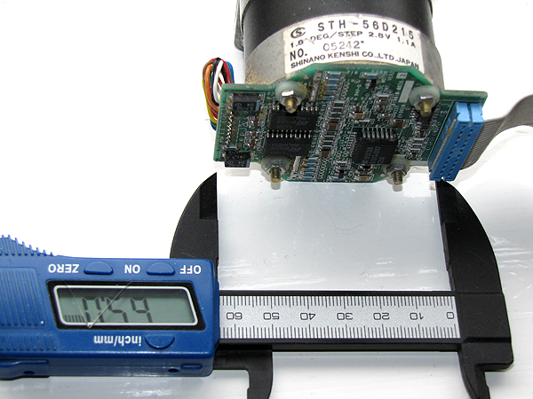

apology to IR ... ETO's Could I ask if the 4x voltage would be suitable with this stepper please. label says 2.8v 1.1 A . the driver chips are L6201 , was off a calcomp plotter.
There isn't much torque on this thing.... Its only a small device and moving the table by hand has only a small friction..
I'll run the motors at 6V and start with a 50 /50 pwm and ramp it up slowly until I'm happy and its undercurrent..

N0 need to apologize... The more info the better!!!

I've just check the henries on the motor and all the windings are 1mH +/- 2%
So that means max voltage of 70Vdc.... According to the "gecko drive site" Vmax = 32 * VL ( Where L is mH )
So if I run these at 24v they should be okay??? I'm hoping to use the GRBL shield....
