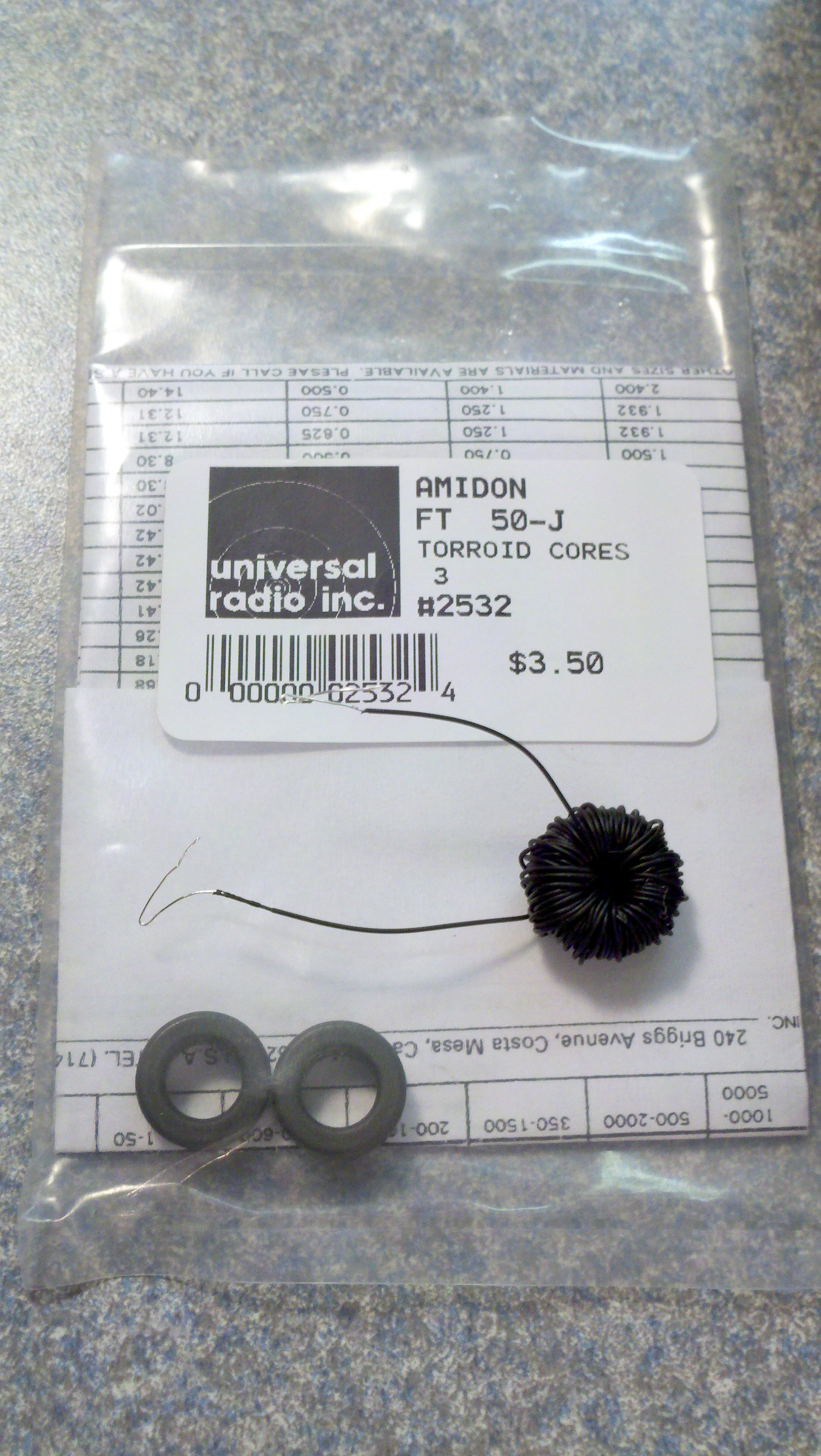

I did find some sources of Ferrite toroids (FT50-J), (Universal Radio) with a material ("J" material) that would take only a few hundred turns to make up the 200 mH I need:
N = 1000 * √([inductance needed]/Aj)
For the "J" material, Aj = 2710, n ~= 271 turns.

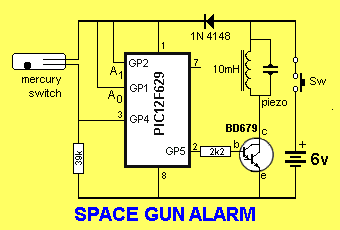

Thanks CZ, it looks like he used a DC-DC inverter type transformer with a 10:1 turns ratio. Then he mentions the hack on the transformer. I hate trying to work from drawings like that. It gets frustrating as all hell.

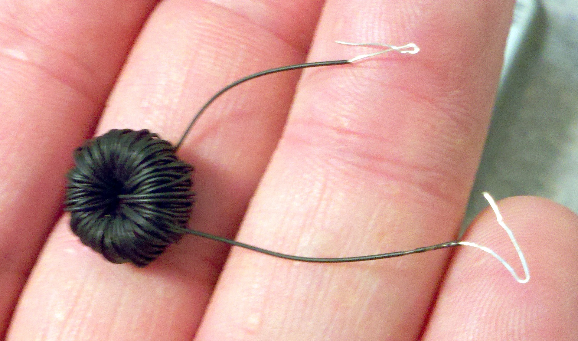

My first attempt at winding a torpid was less than stellar. Using a FT50-J ferrite toroid I was only able to wind 100 turns of 30 AWG wire wrap wire. It yielded 41 mH @ 1 kHz. By the calculations I should have seen on the order of 74 mH.
Getting back to the electronics, what am I doing wrong with the transformer? If all I need is a 1:10 step up, how critical is the actual inductance? I could easily fit 80 turns of the secondary and 8 turns of a primary with the 30 AWG wire on the 12.5 mm toroid.
Use magnetic wire with an enamel coating. You will be able to fit alot more wire in the same space.
Use a high voltage transistor and 10mH inductor. It will be smaller and lighter.
The peak output will depend on getting the resonant frequency correct.

I am afraid I do not have the chops to translate your comment into a circuit I can build. Would you be so kind and sketch out an example circuit?
