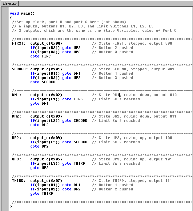

What's the best way to implement a finite state machine in a microcontroller? I have been using a switch statement to transfer between modes. That is, the switch statement is the bulk of main(), but it only executes code for the current state, and each case corresponds to a state.
Is it better (or more accepted) to put each state in a function? Or use another method altogether? Thanks!
I just use linear code. Each block of code has the same labelled entry-point as the corresponding State bubble in the State Transistion Diagram. The State Transitions are all coded as "IF(Condition) THEN GOTO another-state" or its equivalent. If none of the exits from the current State are taken, the last statement is an unconditional GOTO to the entry point in the present state. If there is code that is executed only once upon entering a given state, then you might need two labels, as in STATEnew and STATEloop.

My code is written so that it mimics the State Transition Diagram, which I always draw first before starting to code. I use '***********' to enclose the States, so it is easy to go from code to diagram and vice versa...

I've written many state machines, and I agree the switch statement is the only way to go. Nobody writes if-then-else structure anymore for parallel decision branches, if it can be avoided. That's why the switch statement was invented.
If-then-else statements priority encode your logic, which can be good for some solutions, but not useful for state machines.
I have designed hundreds of state machines, some very complex, which were first hand-drawn as a State Transition Dagram on paper, simulated in a computer program, then were converted to gates/flip-flops for implementation in VLSI logic, were then simulated again using a Hardware Logic Simulator, layed out on Silicon, simulated again using Spice and extracted parasitics. I got most of them to work the first time.

Please post an example coded in C which implements this State Transition Diagram that I posted in this thread.
I think this code would work (in somewhat C-like syntax) - I haven't fully debugged it:
void main() {
  int state = 0; // wait for button

cr0sh,
How did you get from seven states to three? You didn't implement the state transition diagram I posted.
If you think your code implements an equivalent state machine to the one I posted, then working backwards from your posted code, it should be possible to draw out a State Transition Table from the code that could be converted to a Present State - Next State Table for implementation into hardware using flip-flops and gates...

You know - you're right; I didn't implement that same state machine - my bad; the code I originally posted implemented a completely different machine whereby the states were effectively:
1) Waiting for button
2) Get direction (quick transitory state, and could be combined with next one)
3) Move in direction
4) Check limits
Looking at your diagram, I realize now that the states are completely different (your's are states of travel directions and stops); I swear I was looking at it before, but I guess my nature got in my way. I decided to try again; I think the following code implements your diagram properly...?

Here is what my way looks like: What could be simpler or more readable?
I would do one thing to Crsh0's code and that would be to make the "states" an enumerated type. That way the state machine could be coded with descriptive state names. Thus, readibility could be maintained while using structured methods.
