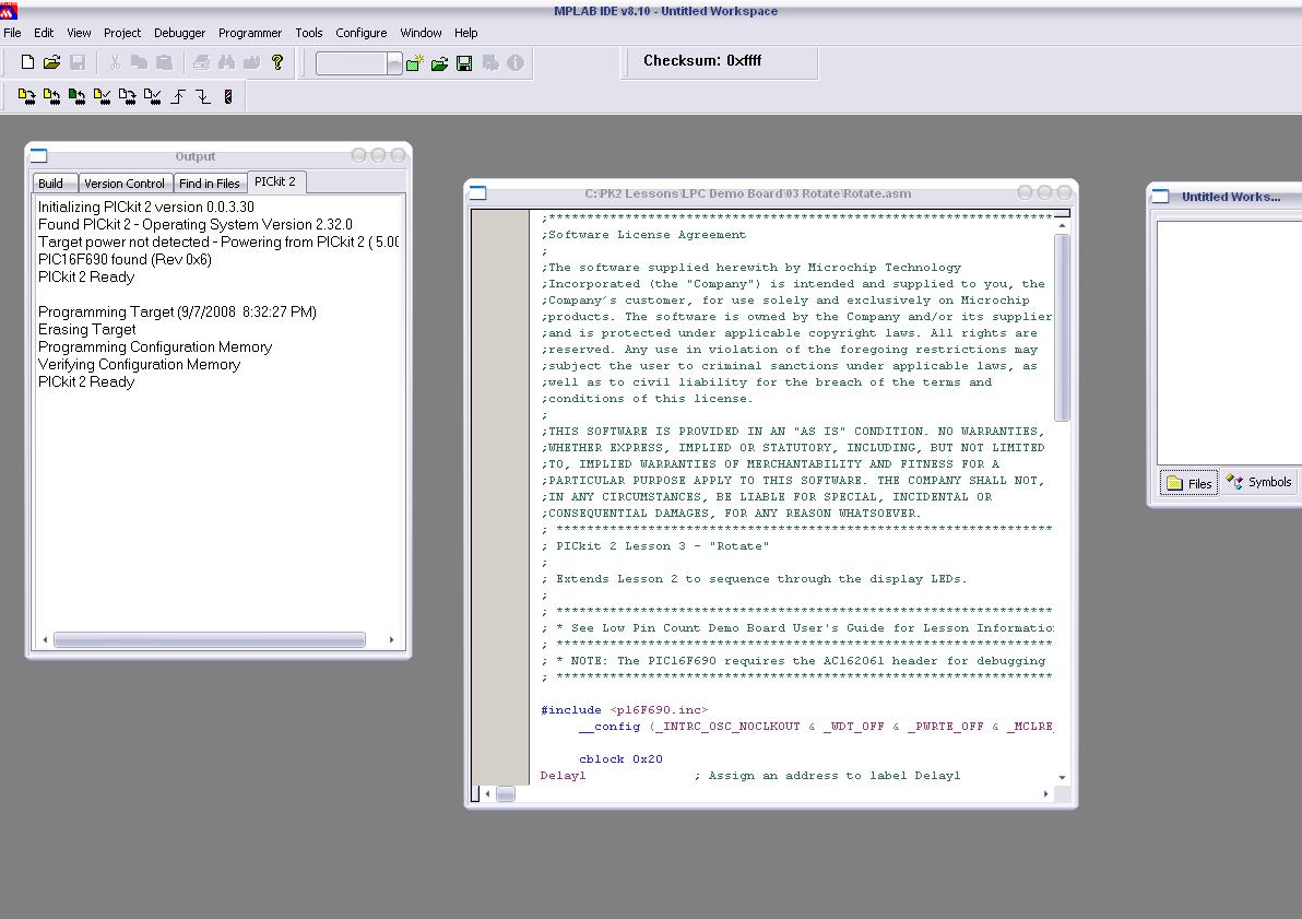

I do have the sample codes, I'm only able to run it when I use the PICkit2 programmer to write the files but not in MPLAB.

This is the screenshot when I chose PICkit2 under Programmer and when I click on write to device.

I can see it now. It looks like you have it set up as a programmer rather than a debugger. It also looks like you have no code to download. Can you post the asm file. Put

Your pickit2 is a debugger. If you select pickit2 under the debugger->select tool menu then it should find your development board and should download the code.

I did exactly as stated and was shown this message:
Initializing PICkit 2 version 0.0.3.30
Found PICkit 2 - Operating System Version 2.32.0
Target power not detected - Powering from PICkit 2 ( 5.00V)
PIC16F690 found (Rev 0x6)
PICkit 2 Ready
and when I click on "Program the target device" this is what is shown:
Programming Target (9/7/2008 9:35:13 PM)
Erasing Target
Programming Program Memory (0x0 - 0x3)
Verifying Program Memory (0x0 - 0x3)
Programming Debug Executive (0x-F00 - 0xFFF)
Verifying Debug Executive (0xF00 - 0xFFF)
Programming Debug Vector
Verifying Debug Vector
Programming Configuration Memory
Verifying Configuration Memory
PK2Error0028: Unable to enter debug mode
NOTE: This device requires an ICD Header for debug. See "Header Specification" DS51292.
PICkit 2 Ready
Is there any steps which I left out?
Looks like I was wrong, the PicKit2 can't debug the 16F690. Strange that Microchip supply it with the PicKit2.:confused:
Oh well, you can only program it. Have you tried doing "release from reset" (on programmer menu) after you program it?

Thanks Pommie! Figured it out,
After writing the code, got to click on Project -> QuickBuild
After that, click on Program the target device
Thanks alot!
Good to hear it's working. One thing to try, on the programmer->settings dialog there is options to program after build and run after program, you should try playing with them. With the right combination you can just hit F10 and it will program and run.
