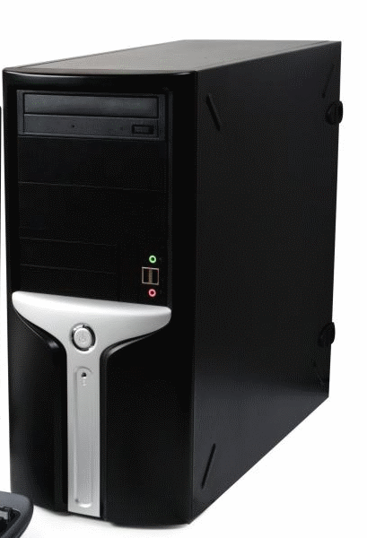

A Photo of the button would be nice.

Hi Guys,
Thanks a lot.
- The device's button is just like the button of the attached PC - in every aspect - i.e. size, required strentch, alignment (i.e. vertical to ground), the plane where the button lays on
- It needs to be pushed for ~6 seconds, and then released

It seems that you can just place this "machine" in front of the PC, and it'd push the button, doesn't it?

go solenoid i will try and do a pic of a mounting bracket later for you, or to be clever go servo route same kind of bracket
