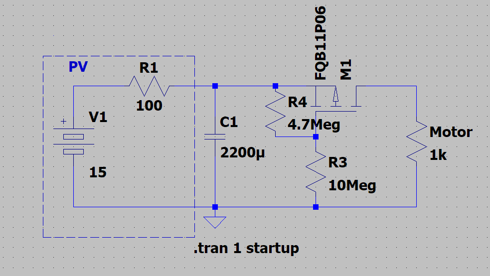

I have wired up a 12V computer fan that can only run through my small solar panel if I start it with my fingers. Can I use a capacitor to build up a charge and boost it into operation?

What is the open circuit output voltage of your PV? Can it actually supply enough current to run the motor, just having issues with starting? Perhaps something as simple as this:
You need a circuit that charges the capacitor and activates the motor ONLY when the capacitor voltage is high enough AND it is sunny.
The Mosfet circuit shown will simply feed the capacitor charging current into the motor before the voltage is high enough.
The mosfet is off until the voltage across the capacitor is >10 volts, at which point it turns on and allows the capacitor to assist with the current surge require for the fan to start. Once it is started, as long as the PV is generating enough to run the fan, it will keep running. If the PV is not generating enough, it might end up going on and off and on and off.....

The IRFZ44 should work in the circuit I posted, You do need to adjust the two gate resistors so that the MOSFET starts to turn on when the capacitor charge is sufficient to start the motor. Data sheet lists the turn on threshold as between 2 volts and 4 volts.
Edit: Just realized the IRFZ44 is an N-channel device so it would have to be installed in the negative power line instead of the positive supply line.
So does this mean when the capacitor is charged to 2 to 4 V it will send the charge to the fan? Or by changing the resistor values I will be able to up this number? I'm not quite sure.
Not sure about this. Once the gate gets to 2V the MOSFET will start to turn on but with a high resistance. This high resistance will wasre power as heat. So, I think it'll be less efficient.

No, there is nothing to sense the voltage on the capacitor then turn on the Mosfet so the Mosfet slowly turns on too soon, before there is enough charge in the capacitor. You need the Mosfet to turn on suddenly at the correct voltage, not slowly at a voltage that is too low.
The MOSFETs Vgs(th) and the resistive divider determine at what point the power starts to come on. Probably want to set that so that the MOSFET starts to come on at about 75% of the maximum available voltage. You are absolutely correct that it will start to come on slowly, and waste some power, but I think at start there may be enough energy stored in the capacitor to get the motor going. Then as long as the PV outputs more than the motor uses, the voltage on the cap will continue to increase and MOSFET will end up fully on.
It certainly is not the ideal circuit, and may not even work. Ideally, one would want a 'snap on' voltage detector that would enable the series pass device. But we are already trying to work with an energy source that is limited and adding a voltage reference and comparator just uses more of that needed energy.
A Cmos comparator is needed that is driving the infinite resistance of the Mosfet gate, draws almost no power.

It is as you say, solar cell too small, fan too big. I would guess most poeple here already know that. The trick is, how to overcome this problem with what I have available. A possible solution has been given and I am currently working on locating the parts needed to try it out. I will let everyone know my results, or troubles in making this circuit.

I know I am supposed to change the resistor values. I used a 1 mega ohm and a 4 mega ohm. I will try to hook it up to the PV, but it's really cold outside right now, like 15F! I wish I had another small PV to test it on, but if I had that, I wouldn't need the circuit! HA HA!
