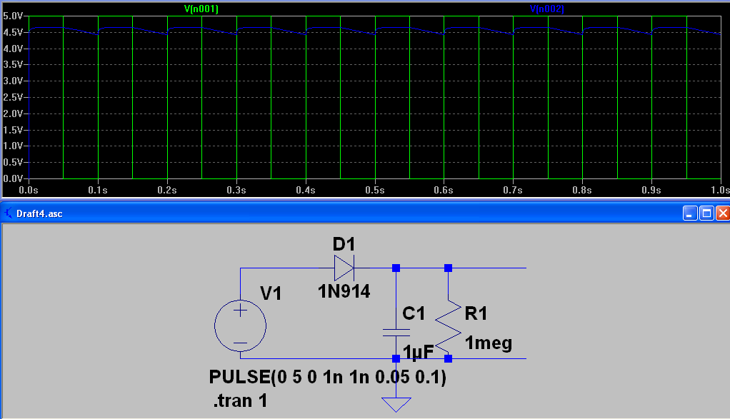

the request is:
take a square wave signal with a fixed width of 0-5V and a variable frequency (3Hz to 10Hz, approximately) and convert it into a continuous signal ...
I hope I was clear...
In the schematic:
Signal source; 0V 5V 10hz
The diode catches the peak signal. The capacitor stores the energy.
There will be some voltage loss because the diode. Vout is 4.7 volts. This is how a volt meter measures AC voltage.
Green trace is the 5Vpp signal. Blue trace is output.

This method will read 2.5 volts because it takes the average. And any change in duty cycle will effect the readings. But because we don't really know what you want to do we are just giving ideas.
I believe "any change in duty cycle" is exactly what he wants to see. He has not stated the duty cycle being fixed.

If so just stick a cap on it and read that put a high ohm resistor across it Like post4 without diode tho.
If it's AC use post 4

tonytnnelectrotech: How long are you willing to wait for the dc level to accurately represent the average value of (pulse width/pulse period) before sampling it with the ADC? (This has to do with how aggressive the filtering has to be.)
How accurate is the 5V peak value of the pulse train? (Does it need to be normalized to the the ADC's Vdd supply in order to make the reading accurate.)
