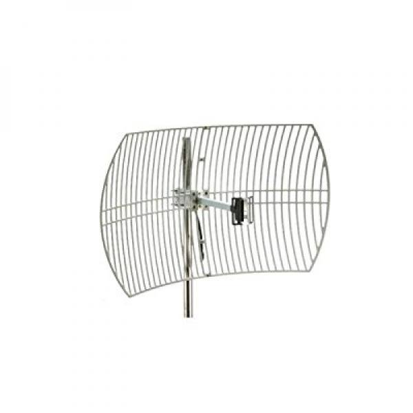

Something like this:
Although I couldn't see any 2.4GHz ones at a quick glance (although there's one on my roof just above my head which used to provide my Internet from 4.5 miles away, and would also connect to the companies main facility 8+ miles away. You can configure them in a large number of ways. They are connected to your router via a POE adaptor, and external grade CAT5/6 cable.
I also have a 5GHz dish I 'acquired' :D, sat in a box about 8 feet away from me.

the dishes would work , but super expensive for only a 30m run

Yes pretty pricey, although you could probably find cheaper makes? - but it does give you the bonus of flooding that direction with WiFi :D Another bonus is it's easy and faster to do - slightly more expensive hardware, but a LOT less work.
I've seen numerous types used, often for holiday accommodation on farms, where they have converted barns and other buildings used, so simply squirt the WiFi to them all in one go.
Nigel's solution may be the best if using multiple buildings. There are wireless repeaters that have one Master and many Clients. With 5Ghz gear, you can easily get full bandwidth. While the cost of these repeaters may be relatively high, it may be cheaper in the long run than trying to bury Ethernet cables (require conduit or special cables). On the down side, it takes a bit more knowledge to set up the wireless repeaters (sometimes called transparent bridges). But vendors do have support for the "better" name brand devices.

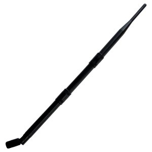

For 22 years I got my WiFi over 2.4ghz 5 miles away. With real good antennas. The 2.4 will not work if there is rain. When I switched to 5ghz it is not affected by rain. This is point to point. The antennas probably have a 10 to 15 degree angle they talk over. Two of these will work "line of sight" for miles.
There are some good antennas that talk over 360 degrees. I have some that say "12db or 15db gain". Two of the 12db antennas reach out much better than the normal antenna.
Here is a picture of a 9db antenna. Note it is 3x longer than normal.
