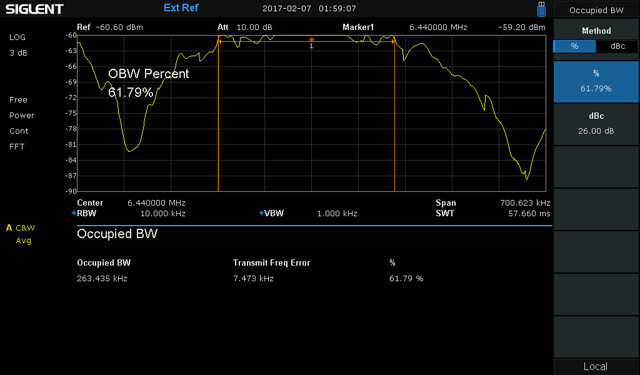

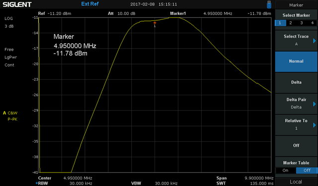

With that said, I find myself trying to get a better understanding of CDMA modulation. So I whipped up a digital bitstream and phase modulated it with a baseband carrier of 4.95 MHz, I even made a 4 pole passive BPF for it.
So below is BPF response.
Okay not pretty, but that what I got with parts on hand.

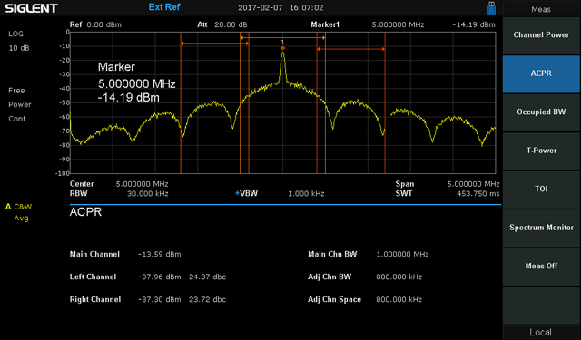

Using my Arbitrary waveform generator set to PSK, and externally modulated with a serial bit stream, I get a waveform somewhat like I expected except I wonder, how on earth do you suppress the carrier wave out of the bandpass, or do you filter to one of the lobes. I dunno, I really have myself perplexed.

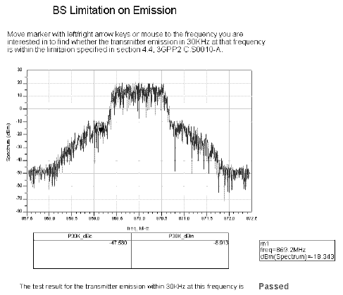

The spread spectrum waveform should resemble something like below image:
My resulting waveform is as shown below:
Zoomed in it looks right, but I am not showing the carrier wave.
I am sure my thinking is just goofy, but I think I need a good head slap to set me right. Thanks

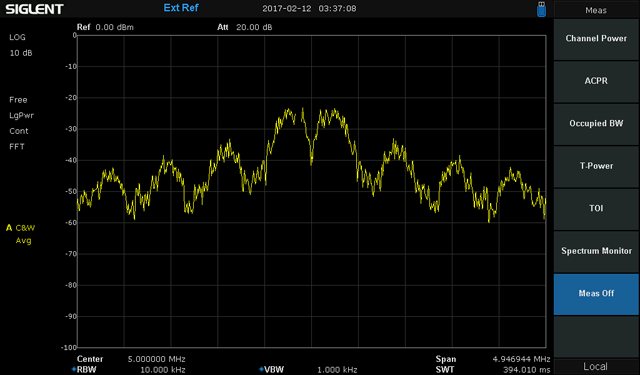

Aren't you supposed to be using a balanced modulator?
Funny you should say that, and I came to that conclusion as well. I started thinking that in a DBL mixer that the carrier should be suppressed by its very nature, so as a test I decided to input my modulating signal and carrier into a Mini-ckts DBL mixer. In the image below you can see better carrier suppression.
