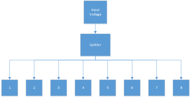

I am fairly new to electronics and I am trying to carry out a project of making a USB charging system. I am having difficulties in trying to split voltage.
Scenario:
I have a voltage of ‘X’ amount, and I am trying to split it into 8 channels of about 10V each.
The reason the voltage is of ‘X’ amount is because I will be using a battery which gets recharged using solar energy so I will not know how much voltage it will carry all the time.
I have attached a diagram to help with my explanation.

I don´t think you need any "splitting" if all you want is 10V DC going to all the devices, you can safely wire them in parallel. The only thing you will need will be some dc-dc converter to get the stable 10V.

You don't need a splitter. If you want to charge many phones through USB, you can buy converter modules like this:
You can connect many of them directly to the same battery (7V to 24V).

I think you can figure out when charging is in progress with an "over current indicator" -circuit:
In above circuit the led D1 lights up when the current is above a set value. You can connect another led in reverse direction in parallel with the first one.. that led will light up when the current is below a set value.
At least that is the concept. You should be able to combine the current sensing and the 5V regulation in one design.. I don't have time to draw anything right now.

The first link I posted (#10) was a switched mode regulator that has very good efficiency and can take in 7 to 24 volts.

you couldnt make it for that price at home, specially when you need a whole bunch of them
with some things its just pointless trying to "reinvent the wheel"
And with the skill level you have so far indicated, it would be a serious undertaking for you,
probably not a project you could yet handle
Also you still seem to be fixated with 10V USB output.... a really really BAD idea
eventually you will plug something into one of those USB ports that is expecting the USB standard of 5V
and you will kill it

Yea I see what you mean.
I'm not after a 10V output from a USB - just a 5V output so it can charge a device via the USB (e.g. a mobile phone)
The reason I am trying to design/make one is because it is supposed to be a project for me to do. If i buy the product mentioned about it just means i didn't really do any work on it (just put things together like a puzzle)
I posted some links about, not sure if you have had a chance to see them, but they are simple circuits used to take in a voltage (like 12V) and output a voltage (like 5v [USB])
I just wanted to know if they would work and how to add some LED's to it to indicate when it is finished charging and when it is charging.
And yea there are going to be many of these boards (x8) which are going to be connected in parallel to each other.
