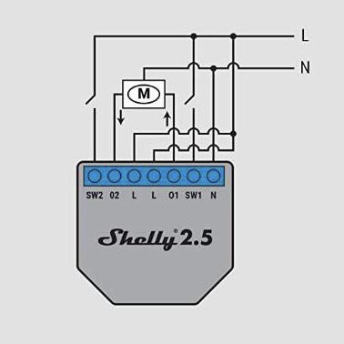

Thanks a lot for your reply.
a photo of the connections is attached.
it’s Shelly 2.5 relay. The motors i don’t know. I don’t have access to them as they are in ceiling..
the pops are at the beginning / end of the cycle. Not during the time the motor is turning. Just when it kicks in and stops.
Can you please direct me where i should put the diode and which site or model i should get please?
Thanks a lot for your time
The diode won't work with AC operation. The relay can be used with DC but that is not your goal. I'm running off to an appointment but maybe someone can add some capacitors to smooth out your spikes for you. Otherwise, give the nice people at Shelly a call/email and let them know your problem.

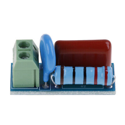

b) Snubbers across the AC contacts. This is an RC series combination. Calculating the value is somewhat of an art.
But 10-100 ohms and maybe 1 uF AC rated capacitor.

I can access the shelly relays as we opened the wall. But can’t access the motor
The motor MAY be a PSC motor that uses a capacitor. You end up with 3 wires with a common, a CW and CCW directions It might be useful if you can find a wiring diagram. You connect c to either the CW or CCW sides.

I'm just using this https://www.hurst-motors.com/lyg42geared.html as a wiring diagram. An AC synchoous motor is essentiall constant speed because speed is related to frequency, so as long as the motor has enough torque, speed will be constant.
There are X and Y capacitors or safety capacitors e.g. https://www.digikey.com/en/product-highlight/k/kemet/emi-suppression-capacitors and thats what you need for a snubber. Also Metal oxide resistors.
They should go across the contacts of your relay. Would need some info about the motor to try to size a value.
A ZNR would probably also help.

Snubber design: https://sciencing.com/design-rc-snubber-12030206.html and https://daycounter.com/Calculators/Snubbers/Snubber-Design-Calculator.phtml
Capacitors: https://uk.rs-online.com/web/c/?sra=oss&r=t&searchTerm=x1+y1+capacitors Note the X1 and Y1 and the voltage rating. https://www.hunker.com/13408990/differences-in-x1-x2-y1-and-y2-capacitors You want an X class.
Metal oxide resistors: https://uk.rs-online.com/web/c/?sra=oss&r=t&searchTerm=metal+oxide+resistors
These can work too: https://uk.rs-online.com/web/c/?sra=oss&r=t&searchTerm=non+inductive+resistors
The snubber will go across the relay contacts.
ZNR's Search for ZNR's at RS-oniine. You probably want 240V operating. The ZNR across the line in and motor so you would end up with three.

do you think that this will do the job?
The MOV is 10D471K, https://www.mouser.com/datasheet/2/54/mov10d-777448.pdf. Hopefully, R2 is a 10 ohm 2% resistor.
It could be closer to your line voltage.
Some info about your motor and we can calculate possibly better values. The seller doesn't know what he is selling. This https://www.amazon.com/Firiodr-Inductive-Solenoid-Interrupter-Protection/dp/B07VB8FNSK/ref=pd_sbs_5? shows a 22 ohm resistor/
of 22 ohms.
Get the values you needed by the calculator from the motor specs. Your pretty much going to need 3 of them.
The PCB is "sort of nice" No mounting holes. The terminals might not even accept the wire used. Lot's of potential gotcha's. for a simple product.
A large piece of heat shrink tubing to cover the module would be really useful.

I think you will effectively need 3 units.
One fro CW and neutral. One from CCW and neutral. And one across the line.
You can change the varistor part number based on your line voltage.
The product of R*C matters more. R in ohms and C in Farads. 780 pf = 780e-12. .1 uf = 0.1e-6.
