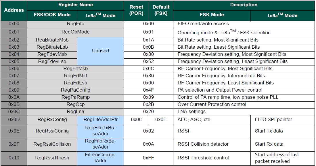

I've been trying for weeks to crack SX1276 radio modules. The data sheet is VERY complicated! From what I can gather the registers defaults are programmed in the chip, and need changing for e,g, different frequencies etc. The chip has to be ASLEEP or STANDBY for read/write.

Hi Eric,
Here is part of the data sheet:
There is a second similar exploded section with more detail!
1/ What do the HEX numbers in the SPI code mean e,g, 0x06?
2/ If I only wanted to read 'say' ADDRESS 0x02, I would expect the reply to be 0x1A. What would the minimum SPI code look like?

Hi Eric,
1/OK
3/OK
2/Not clear! From the Table I posted, if I only want to READ ADDRESS 0x02, the Table shows the default as 0x1A What would the minimum SPI code look like? (No writing only read) Commuting with these devices needs lots of settings, all I'm trying to do first is to confirm, I'm commuting with it.
FROM DATA SHEET: Configuration registers are accessed through the SPI interface. Registers are readable in all device mode including Sleep. However, they should be written only in Sleep and Standby modes.

Hi
Const RegBitRateMsb = 0x02
dim data as byte
SPICSOn
SPISend RegBitRateMsb
WaitUs 10
SPIReceive data; if the Default 'data' value is still in this Reg it will return 0x1a; or what ever value you previously Wrote to RegBitRateMsb
SPICSOff

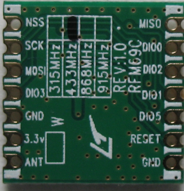

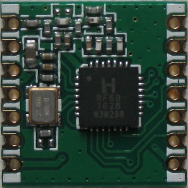

Hi Eric,
To clarify: I use the term CHIP when I'm talking about the actual SX1276. CHIP MODULE when I'm talking about a board with a CHiP + Crystal, and a MODULE when I'm talking about a board with a CHIP +crystal + controlling Chip (Which tend to use ATMEGA).
I have CHIP MODULES: Attached
I've connected them PIC SCK to SCK--PIC SDO to MOSI--PIC SDI to MISO and PIC ???? to CS (Basically any pin on PIC??)
I may have found an error, I'll check again, and return.
C.
