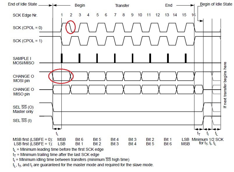

I'm wondering about the following timing diagram from Wikipedia (SPI term), regarding SPI Mode 0,0:
in SPI Mode 0,0, the data is transmitted at falling edge.
Therefore, how come in the diagram, the first falling edge (in CPOL = 0) occurs just before bit #2 is transmitted? (in CPHA = 0)
I expected the first falling edge to occur just before bit #1 is transmitted.
How come the 1st bit was transmitted before the first falling edge?
thank you.
SPI_timing_diagram2.svg

I have a specific question on the timing diagram from the this great tutorial.
In CKE = 0 mode, bit#0 on the SDO line has much longer duration, than in CKE = 1 mode.
Why is that?
hi RF,
All that the d/s waveform is showing is that the SD0 line remains in the state of the last bit 0 transferred.
Note also that at the Start [ the greyed SD0] is shown as being indeterminate, whatever the last state was.
E

I was referring to the mode - CPHA = 0, CPOL = 0.
At that mode, the bit#0 extends much longer after the last edge - why?
Moreover, at that mode, bit #0 is sampled with no Rising Edge present - how is that?

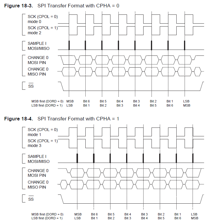

I have a question on its timing diagram from CPHA = 0, CPOL = 0
In this mode, the bytes are propogated on the SDO line on the falling edge.
However, as you can see in the diagram - the 1st byte (circled in red) is propogated on the SDO line before the falling edge (circled in red).
How do you explain it please?

I see the same phenomena in your Graph for CPHA = CPOL = 0.
The first byte appears on the SDO line BEFORE the first falling edge of the clock - how come?
You are looking at four actual modes
leading edge!!!
CPHA = 0 CPOL = 0 ( top diagram... Rising edge of clock )
CPHA = 0 CPOL = 1 ( top diagram... Falling edge of clock )
Trailing edge!!
CPHA = 1 CPOL = 0 ( Bottom diagram... Falling edge of clock )
CPHA = 1 CPOL = 1 ( Bottom diagram... Rising edge of clock )
If you look carefully if you shift the diagram the read is in the same place on all four...

In CPHA=CPOL=0, the data should be propogared to the SDO line at falling edge, right?
so, how come before the first falling edge, the first byte was already propogated to the sdo line?
It isn't.....
CPHA = 0, CPOL = 0.. is the leading edge rising...
CPHA = 0, CPOL =1.. is the leading edge falling...
CPHA = 0, CPOL = 0.. CANNOT be falling edge...

The red Circles I marked are from CHPA = 0 Graph.
According to Protocol, in CPHA=CPOL=0, the data is propogated in falling edge - do you disagree with that?

The data is read on the rising edge and propagated on the falling edge... Propagated means written / transmitted..
You do know that SPI is a circular buffer? As far as we are concerned, we really only need to know when the buffer is read...
I have re-read the entire thread.... I see what you need to know.... I thought your confusion was the SPI module reading the buffer.... As the last post ( hopefully explains ), the SD0 is sampled first, then sent/propagated... You don't need to know about the propagation... It's internal....
