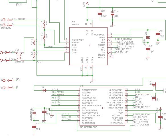

I'm trying to communicate the PIC18F2580 to MCP3911, but i can´t make the interface SPI work

Maybe you haven't got a reply because you haven't given any information on what you are currently trying.
If you want code for SPI there is plenty around on the net, if you want your code fixed you would have to post it.
Well, this is the source code that i use for the customization of the SPI port, but i maked a few tests with a osciloscope and i had comfirmed that the port work; but the all pads from mcp3911 doesn´t show any signal. i'm using mplab 8 and Hitech picc-18
this is the code:

this is the section of the main code i'm using for the firmware
