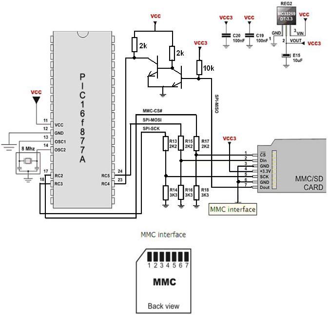

Hi, i hope you're all doing well .
i'm trying to implement an interface between a PIC16f877a (8Mhz xtal) and an MMC, and i have a bit of a problem with CCS, now i understand that MMC requires a clock lower than 400khz for initialization and that's what i did, the code is running with SPI_CLK_DIV_64 (125khz).
my question is, what code should i add to speed up the SPI connection? i mean should i just redefine the SPI setup: Setup_spi(SPI_CLK_DIV_4) ?!
my second question concerns the bus interface circuitry, what Transistors do you recommend using ?

Thank you
you can use any small NPNs like 2N3904 etc.
i have some 2N2222 lying around and they seem comparable to the one you mentioned, thanks for your answer i really appreciate it :)
