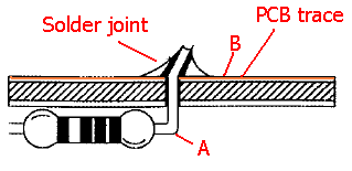

so for example in this picture:
i will test circle with circle and square with square right?? and if i hear a beep on my multimeter that means it has continuity... If yes i did this already and every solder joint has continuity with at least another solder joint
No, that's not right. By doing that check that you are depicting in the photograph what you are actually checking in continuity of the circuit board trace, not of the component to the trace. What you want to make sure is that the components that you soldered in place are electrically connected to the circuit board traces. Measure between point A and B like in the picture. That will tell you if you have a good solder joint of not. Make sure the lead on your multimeter is getting through the green coating over the traces. Also, make sure that there aren't any solder joints that are so messy they connect parts of the circuit that shouldn;t be connected.

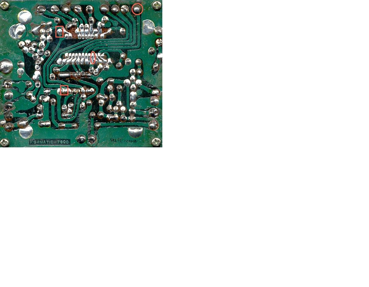

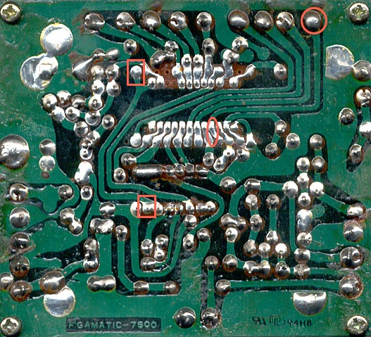

Woops commented on the PCB in the picture then realised it was not the PCB in question.
