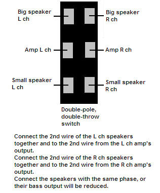

Your single-pole switch is shorting the amplifier outputs together.
To switch stereo speakers, you need a double-pole switch so that the amplifiers are separated from each other.
you meen like a 6-pin one? like this (bottom view):
because that is what switch i have got, but i have only used 1 row (as shown in the diagram in my 1st post)
Good, you found a DPDT switch. Wire it like this:
ok, thanks for that, should this stop the high pitch noise then?

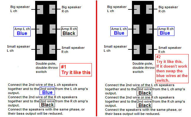

Edit: i have just had a proper look at your switch diagram, and i noticed it had left and right channels, i only have one (right i think) with 4 wires going to it (2 for 1 set of speakers and 2 for the other) and i want 1 OR the other to come on, so would this work? (sorry, the 1stdiagram was misleading as it had 2 seperate wires comeing out of the amp)
Sorry for the confusing pic
Thanks,
Mike
If you didnt do it, swap the two black wires that are connected to the switch.
Since your amp has 4 output wires the it gotta be a stereo amp with a left channel and a right channel.
It's too bad that you didn't label the wires when you disconnected the original speakers. One channel could have blue wires and the other channel black wires as in my sketch.
Or one channel could have a blue and a black wire and the other channel the other blue and black wire. Then one blue wire goes with one black wire and it is easy to get them mixed-up.
You don't know what you have, and I don't know what you have. Good luck.

hi, the 1st diagram worked, thanks i can now listen to loud music clearly.
I think my explinations of what type of amp it is were confusing, i was using 1 output (2 conections) with 4 wires comeing from it BUT, there are actualy 2 outputs (but i am only using 1)
Thanks again for your help
