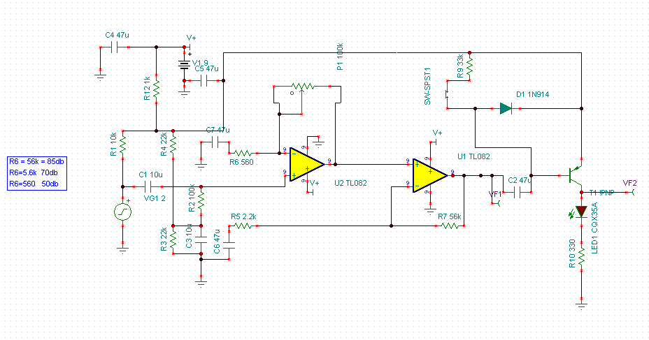

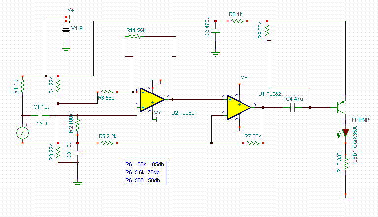

I want to compare the output of three different a,ps for my critter ridder
A Bridge amp, no output transistor and a single transistor. Very simple so called amps. Output is a square wave.
thought about using a lm3616 LED vu circuit but found attached schematic which is supposed to make the LED flash wen the desired db level is reached (R6 is supposed to be a 3 pos switch but planning on just inserting a 10 turn pot.
in simulation I can't get the LED to come on. The original circuit used a LM358 op amp. reason for using the TL082 = I have one on hand.
any suggestions ?
original circuit is a room noise detector used search engine (url ?? will locate)

I inserted a diode across the base to the collector - still won't simulate.
Guess I am going to just have to breadboard the darn circuit. I think the TL082 should work as it is usable for single or duel supply.

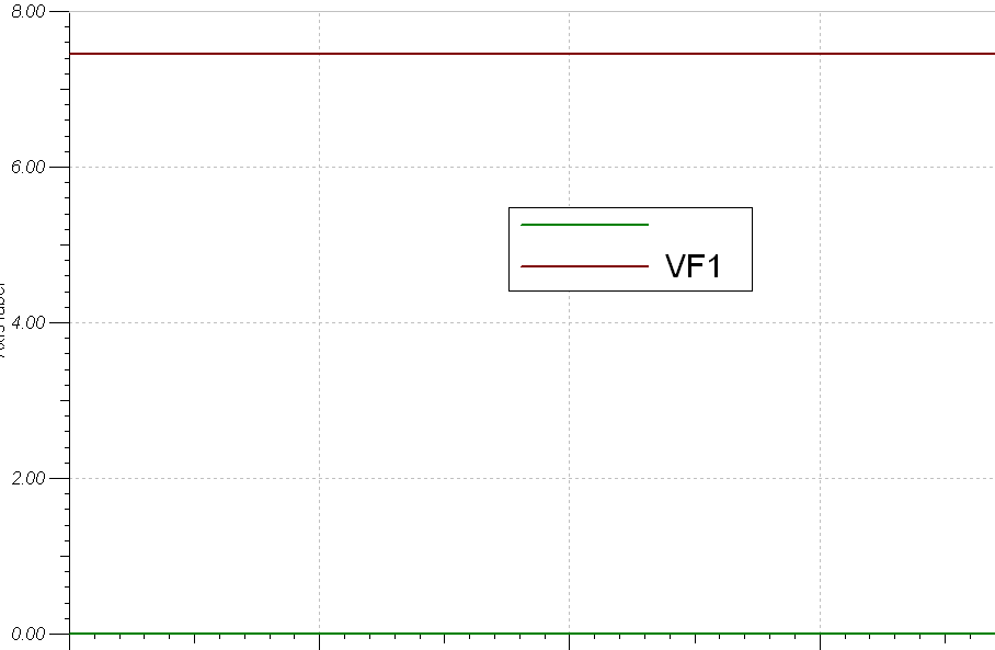

Hi. What is the optput reading (oscilloscope picture) from the second opamp output?

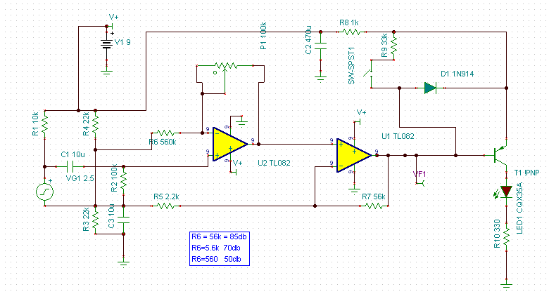

circuit mods
I took out the output cap and have 2.5v dc in put for input signal
here is present scope pic
I found a similar thread and it was suggested to remove cap.
I bread-boarded a condenser mic, battery, cap and DMM but didn't get any reading.
All I want to do is compare output performance of the three output amps.

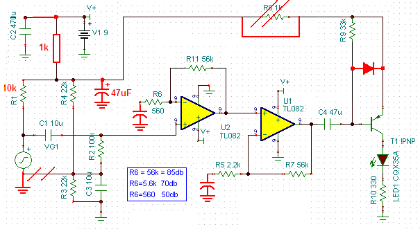

Another problem I see is that resistor R8 will limit the current so much that the led will probably never light. Even if transistor T1 (should be Q1) is near saturated, the current (assume V_led=2V) will only be around 5 mA.
I think the circuit doesn't work because instead of the mic being connected to ground it is connected to the high resistance bias voltage (across C3) so the current in the mic is messing up the bias voltage for the opamps.
I increased the value of R1 and added an RC filter.
The circuit is designed for an electret mic, not a condenser mic but many stores confuse the two. A simulation program does not know a microphone.
R5 and R6 do not need a DC bias voltage so I replaced their connections with capacitors to ground. The value of the capacitors affects the low frequency response.
I added a diode so that C4 does not charge and charge without anything to discharge it. If nothing discharges it then the LED will turn off when it should turn on.
I removed R8.
But I did not remove the chicken pox dots all over the place!

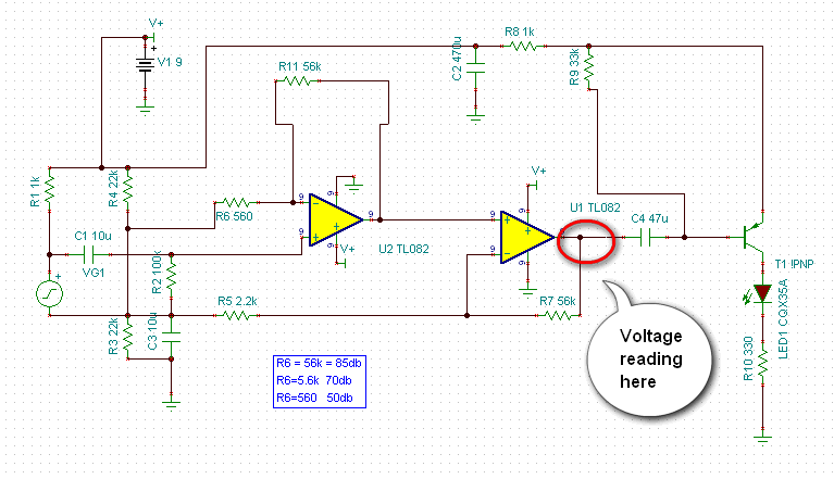

here is revised circuit.

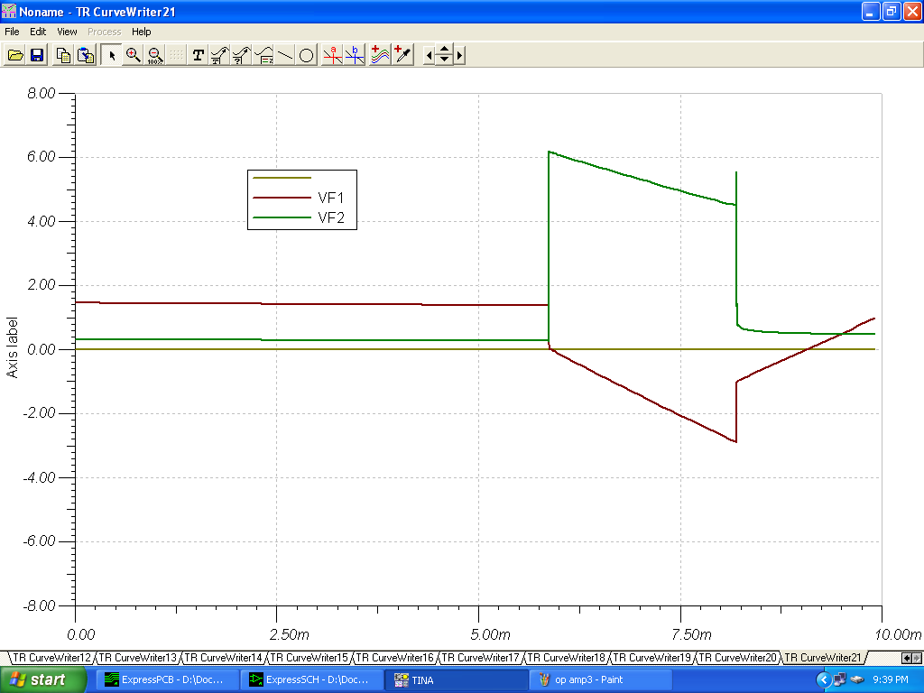

It dawned on me that the LED is going to flash so just a voltmeter won't cut it.
Here is a pic on ossiscope
hopefully adjusting R11 will allow me to adjust for different db levels
Oups I need to put a pot on R6 not R11

If you use a pot for R6 then the gain for low frequencies will be changed differently to the gain for high frequencies, unless the capacitor to ground is huge which will take time to charge when the circuit is first turned on.
But a pot for R11 will reduce the gain for all frequencies equally.
I thought your oscillator will sweep frequencies or jump between two frequencies? You can test the sound levels by feeding the amps with a continuous oscillator always at the same single frequency.
I drew my circuit wrong and you copied the error. The emitter of the transistor, D1 and R9 should connect directly to the (+) of the battery, not to C5. Then your 'scope waveform will probably be squarer.
I planed on testing using a 555 oscillator set at one frequency. That way ALL the tests should be equal but different results.
will change the connections. I wondered why the 1k but then you know best.
The 1k resistor R12 and C5 make a filter for the bias voltages for the mic and opamps. Without the filter, the battery voltage bouncing from the load's current will cause oscillation.

There are two wire electret mics and three wire electret mics. They are connected completely differently.
A two wire mic is the most common and it has an output/supply pin and a ground pin that is connected to its metal case.
I have never seen a three wire electret mic but there are tutorials on the internet that show how to wire one pin to a positive supply, another pin as its output which maybe it needs a resistor to ground and a ground pin. It doesn't need a resistor to power it since it has a power input pin.
using the schematic you posted, if I directly connect the 555 output to pin 3 of the first op amp I should get the LED to light (want to test if the op amp circuitry is working.
No.
The output of an electret mic is only 0.01V so the circuit has a high gain. The output of the 555 is 8V which is 800 times too high!
Pin 3 needs an attenuated signal to be capacitor-coupled to it.
never worked with condenser mic
I don't know if you have a condenser mic or an electret mic which are completely different. The circuit is designed for a two-wire electret mic that has the high voltage built into its electret material and has a Jfet impedance reducer. A condenser mic needs a 48V power supply plus a very high impedance preamp.

If you remove R11 from the first opamp then the gain of it will be 200,000 at very low frequencies instead of 100. You don't want that.
