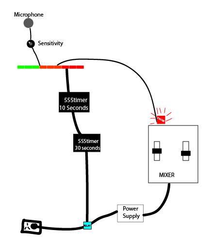

What i wanted to do was, i have a mixer that all the music sources goes to and then to the speaker, I would like to make something with leds to show the volume level, when it gets over a certain say 4 green leds it goes into orange and a small flashing light comes on ontop of the mixer. If it goes into red a 5 second timer comes on and if its still in the red after 5 seconds it turns off the mixer for 30 seconds / then they turn down the mixer.
the mixer has a 4 pin round power socket and the power supply ready 2x 18v/ 500ma.
My thought was.
A level indicator > timers > relay to turn off the mixer either in the 240v stage or after the transformer in the 18v stage.
any thoughts help, ideas, schematics or links would be appreciated. thanks
Something like this.
what doesn't make any sense? i need to make something that shows my customers who hire the venue the when in green the sound is fine, if its turned up too much it goes in orange and a strobe flashes, if its too loud it goes in the red and triggers a 5 second timer (to skip any bass or loud hits in the audio) if its solid in red for 5 seconds it then triggers the next timer which disables power to the mixer hence no sound to the speaker, for 30 seconds. It comes back on after 30 seconds and when they know this is on they wont turn it so loud again.
Did that make better sense?

You can make some automatic volume attenuation... the timers I do not see how this makes any sense...
I see lack of coherency with what you are suggesting in your schema. It is like you are suggesting some sort of closed loop control that is completely bananas.
Don't get me wrong, I mean what you do need is closed loop control, but not with timers to switch the whole thing off... take caution with closed loop control because it may oscillate...
You can make an VU (Volume Units) -- meter and if the red led comes on then automatically throttle back / attenuate the volume...

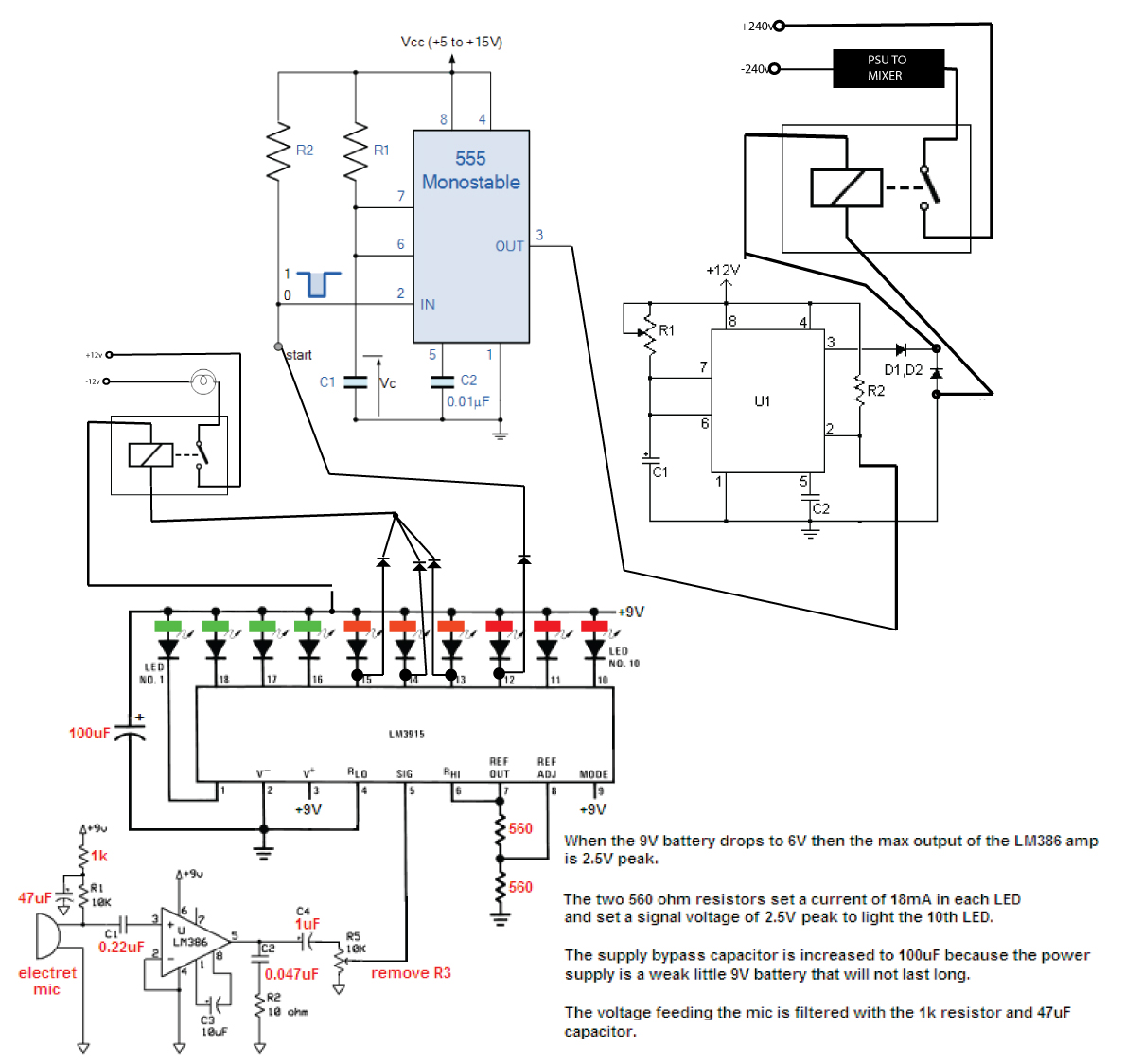

I have put this together from some links you have supplied.
I know just putting this together wont just work as i need to work out the timers which is where i ask for detailed help.
I want the first timer to kick in when the first red led lights, it has to be activated for more than 5 seconds (but would like adjustable time) if the time exceeds 5 seconds then it sends a trigger to the second timer that triggers that to output to the relay and disable the relay for a fixed time (30 seconds but would like adjustable from 5 sec to 1 min)
Please dont abuse me about how i have put the circuit drawing together, im not expert, thats why im asking the experts!

Just right off the top where you are driving a relay with the 3915 chip. You may want to have the 3915 drive a transistor to in turn drive the relay coil. Relay coils will also need some flyback diodes but overall, you have the idea. Tomorrow I'll better look at this and maybe come up with a few ideas for you.

Hey, not a bad first cut. Initially, I see:
1) Bypass caps should be 0.1 to 1 uf and usually ceramic or possibly tantalum. They are located close to the ICs.
So, the LM gets one, the OP amp gets one and the timers get one.
2) I don't think a 9V battery source will work. It would have trouble driving a relay. 9V relay are uncommon.
You might have to go with a sealed lead acid or LiPo.
3) Coil suppression diodes are missing. They protect the semiconductors driving the coils.
4) In bar mode, you only have to detect the lowest LED, not all three. In DOT mode power consumption is reduced and you do have to detect more LEDS being on.
5) The datasheet says the cartoon isn't accurate and provides a mini schematic of the output circuit. For the LED's you'd like to monitor. So, I would use a series connected optocoupler with the LED with either FET or a transistor output. That gives you an uncommitted NPN transistor usually.
6) Things do get messy when trying to do timing after about 4 seconds. The capacitor selection is critical and the timing accuracy gets bad. The tolerances of electrolytic caps are to blame/ There are better ways of doing long delays. See **broken link removed**
7) You might look into the 7555 timer. A lower power cousin.
8) I did not look at the set/reset.
Impressed,otherwise, for cut/paste. Let's see what others have to say.

Your circuit triggers the 555 on the momentary peak sound level. It might be from a hand clap, a foot stomp or a cough. What about laughter?
Don't you want it to trigger on the average sound level?
Audio guru, the reason why the first timer is set at 5 seconds (doesn't have to be accurate) is to deal with the problem of claps, laughter or bass hits. If the timer receives the trigger for longer then 5 seconds +/- then it triggers the next timer to turn off the sound.
This is one of the reasons i wanted the timers variable so i can mess with the timing and even move it to the second red led.
Keep it simple.. Thanks, some of that made sense. and ill wait for more input too, i dont think my knowledge is good enought to jump in and start adding bits etc
