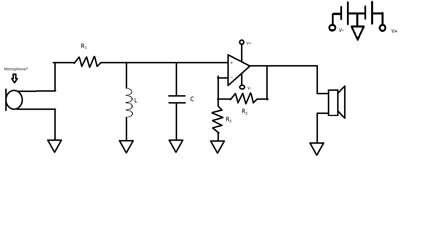

Me and my friend are working on a project in school, in which we are intending to record sound using a michrophone, filter out unwanted frequencies using a band pass filter circuit (see: below), and finally send it out through a speaker.
Lowest frequency= (R1)/(2πL)
Highest frequency= 1/( 2π(R1)*C )
Gain= 1+R2/R3

We're planning on using a very small microphone, and a very small speaker.
Do you think this circuit will work the way we want it to? We've got very little knowledge in electronics, the circuit and formulas are based on things we found online.
Probably not.
There will be some filtering effect due to the tuned LC circuit and R1.
Low and high frequencies will be attenuated compared with those at the resonant frequency of the LC circuit, but how much attenuation is difficult to determine with the information available.
Also be aware that the filtering effect will be gradual, there will not be a sharp cut-off between the passband and stopband.
You may also need a resistor between the LC and the input of the opamp.
You will likely need two amplifiers; one that is doing the filtering and the other that is driving the speaker. The first can be a generic opamp; the second an audio power amplifier like an LM386. The total signal amplification from microphone level to speaker level can be distributed over the two amplifiers.

The part of the circuit with the resistor and inductor and capacitor forms a bandpass filter. A bandpass filter has two frequencies where the response is 3db down. The two angular frequencies are:
w1=(sqrt(4*C*L*R^2+L^2)+L)/(2*C*L*R), and
w2=(sqrt(4*C*L*R^2+L^2)-L)/(2*C*L*R)
the two frequencies in Hertz are then:
f1=w1/(2*pi)
f2=w2/(2*pi)
So it's a little more complicated then you might have originally thought, but not that much more. The op amp section just amplifies all the frequencies up to the limit of it's specs.
Notice the two formulas are almost the same except in the numerator where one has L added and the other has L subtracted.
Also, R in the formula is R1 in the schematic PLUS any series resistance of the microphone. So if R1 in the schematic is 1k and the mic has 600 ohms impedance then R in the formula becomes 1000+600=1600 ohms.
Another point is that these formulas are exact when the inductor and capacitor have zero equivalent series resistance. When there is a little series resistance in either the response will be slightly different but it should be close enough for most purposes.
As a final note, the bandpass filter above has a peak at some value of frequency between w1 and w2. The peak for this filter occurs with a value of angular frequency of:
w=1/sqrt(L*C)
and so the frequency in Hertz where the peak occurs is at:
f=w/(2*pi)

The gain of your circuit, the part with the R, L and C, is as follows:
Amplitude=Vin*(w*L)/sqrt((R-w^2*C*L*R)^2+w^2*L^2)

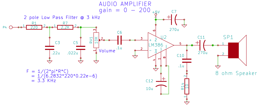

This schematic represents a working design for the LM386 amplifier. It attaches to a PIC18 micro-controller to convert a square-wave audio tone to something more sinusoidal and to drive an 8 ohm speaker.
This amp has a voltage gain of 20 by default (26dB). Placing a 10uF cap between pins 1 and 8 will increase the gain to 200 (46dB). See the data sheet for more details.
The advantage of the LM386 is that the output is DC biased to 1/2 VCC. This provides maximum drive capability with the lowest idle current making it a good choice for battery operated circuits.

An opamp is usually used as a mic preamp but the value of R7 is so low that it will short the output of the preamp.
It is good that the value of R8 is 10 times higher than the value of R7 but if R7 is increased to 1k (and C12 also re-calculated) then R8 should be 4.7k and C13 re-calculated.
R9 does nothing but reduce the output level and should be replaced with a piece of wire.
Since the new value of R8 will be 4.7k then the value of the volume control should be 5 times higher at about 24k but use 20k if you can find it.
Why do you have two 180uF output capacitors in parallel? Instead use one 330uF or 470uF instead and you will not hear any difference.

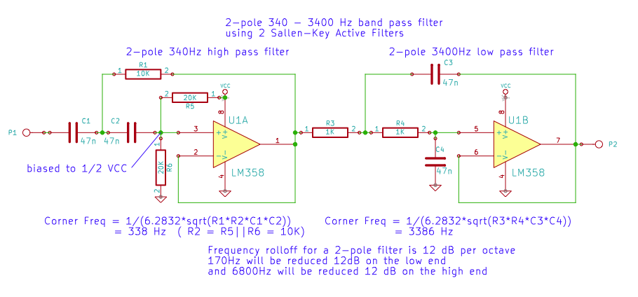

The circuit in post #6 has another problem. The first op-amp will undoubtable have a fair bit of gain depending on the sensitiviy of the mic. It is DC coupled and therefore will amplify its own input offset voltage - maybe to the point of damaging the speaker as the 386 also is DC coupled.
A capacitor ~1uF in series with R5 will help as it forces the front end op-amp to have unity DC gain.

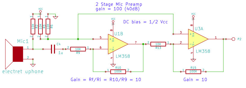

Both opamps are configured for unity gain. So a microphone preamp will be needed.
(audioguru informed us that this had not been properly biased - R5 and R6 should fix this.)
The LM386 Amplifier in #9 already has a 2-pole low pass at @3000 Hz. If the circuit of #9 were added to P2 on the output of this Sallen-Key band pass you'd get an additional 12 dB per octave rolloff. So you'd get @ 24 dB attenuation at 6800 Hz.

Post #9 has TWO highpass filters:
1) C11 is 0.1uF and it feeds the 50k resistor to ground at the input of the LM386 amplifier that is shown on its datasheet. The cutoff frequency is 32Hz.
2) C10 and C14 in parallel are feeding the 8 ohm speaker with a cutoff frequency of 56Hz.
Both filters cut low frequencies so the total cutoff frequency is about 88Hz. Their total can be 300Hz if you want.

The circuit in post #17 is not biased properly so IT WILL NOT WORK.
Both opamps are configured for unity gain. So another stage before this will be needed to amplify the microphone.
