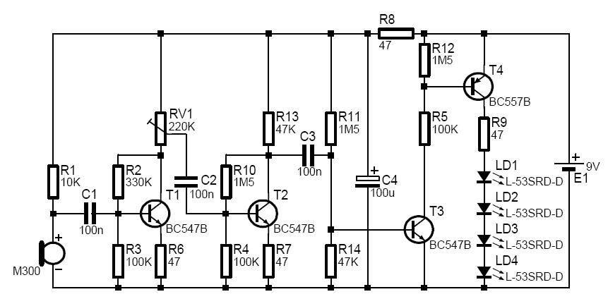

would this circuit work? i found it on the internet:

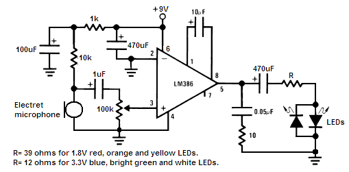

I don't think your large, complicated and expensive circuit would light the LEDs on bass sounds very well.
This small, simple and inexpensive circuit will:

thanks for that :) the chip is only about 36p and i think i have most of the other components :) thanks alot for that.
I'll let you know how i get on
