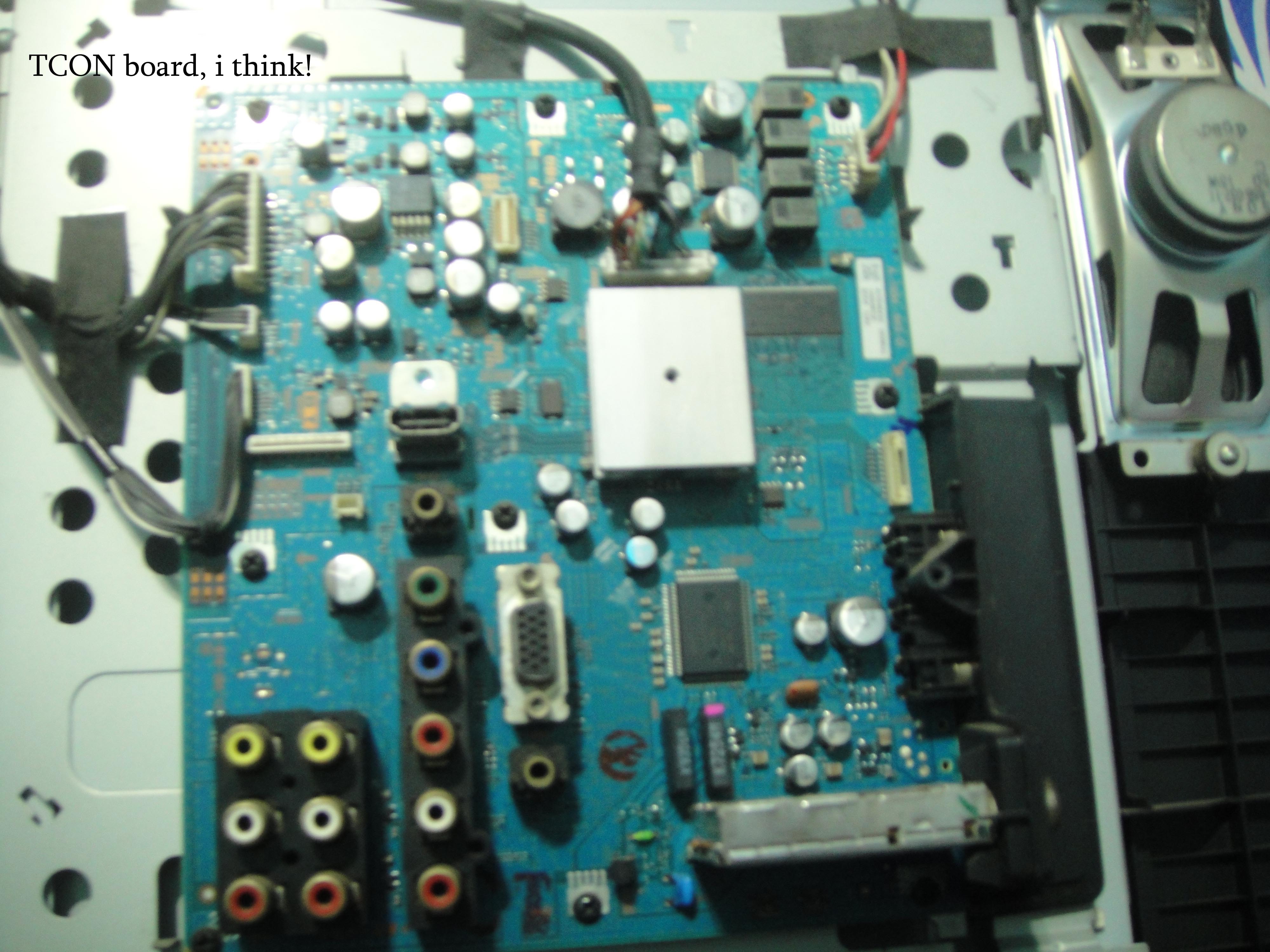

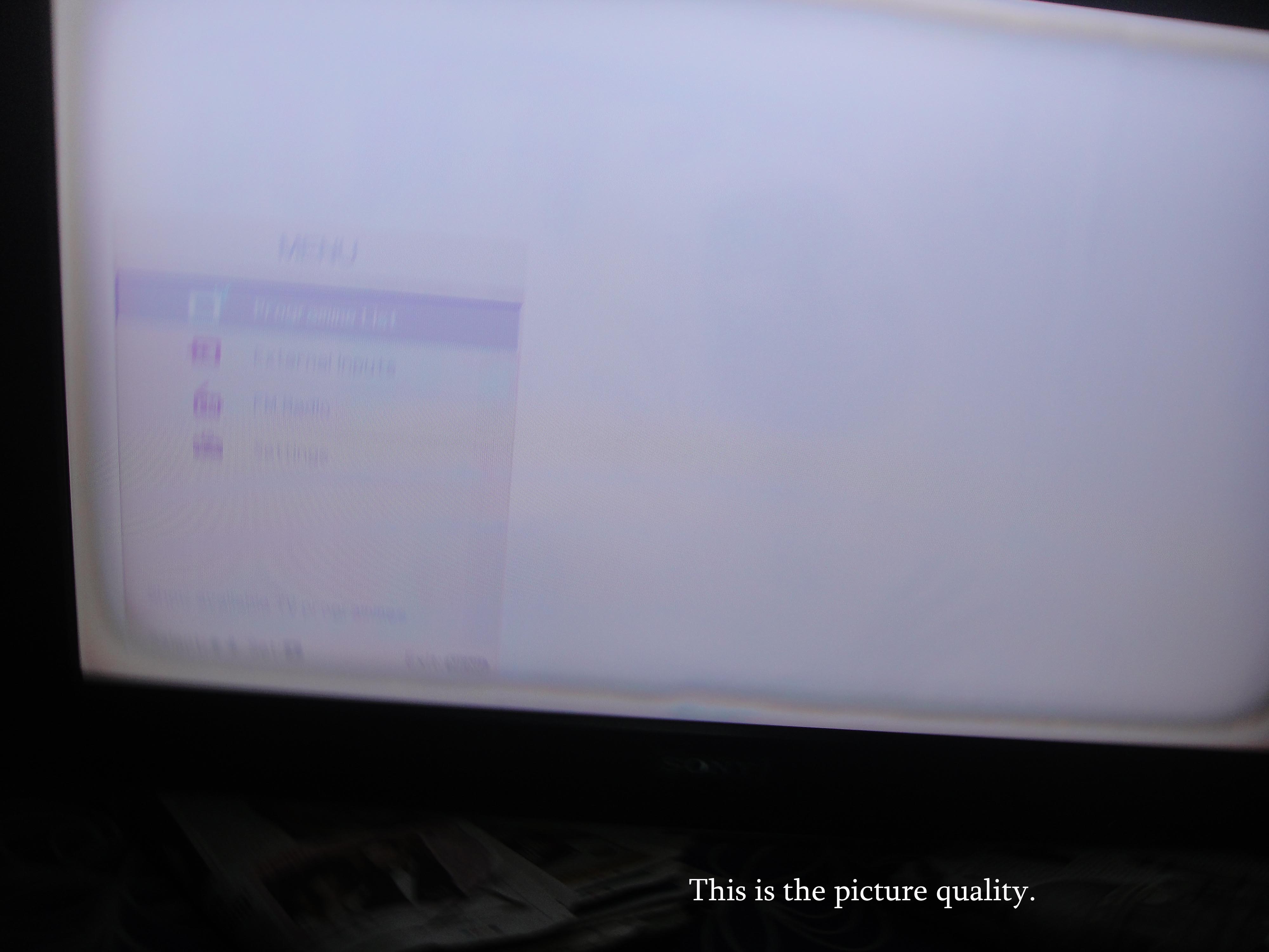

hi, everyone.. in my home we have a KLV-32T400A TV... one month ago the picture showed some negative and white effect... i have search the NEt to find out what is problem of it... according to net it has the problem of TCON board.... here are some picture of the TCON board and the display of the LCD... i have done some cold check, but still not able to find out anything.... DSC04987.JPG
i am currently working on it.... any one who want to or can help me please post of view...... thank you..
That's NOT the TCON board (it's the main board), the TCON board is part of the LCD and comes as part of it.
If you look at your picture labelled 'closer view' there's a thick black multicore cable going up at the top left, that goes to the TCON board.
It's almost always under a screening can, and it's possible that there 'may' be a small SM fuse that's failed on there.

The OP is quite right it could well be a fault on the TCON board, and often a blown SM fuse.
To the OP - the screening can is easily removed by a number of small pozidrive screws - you may need a jewellers screwdriver if you don;t have one small enough.

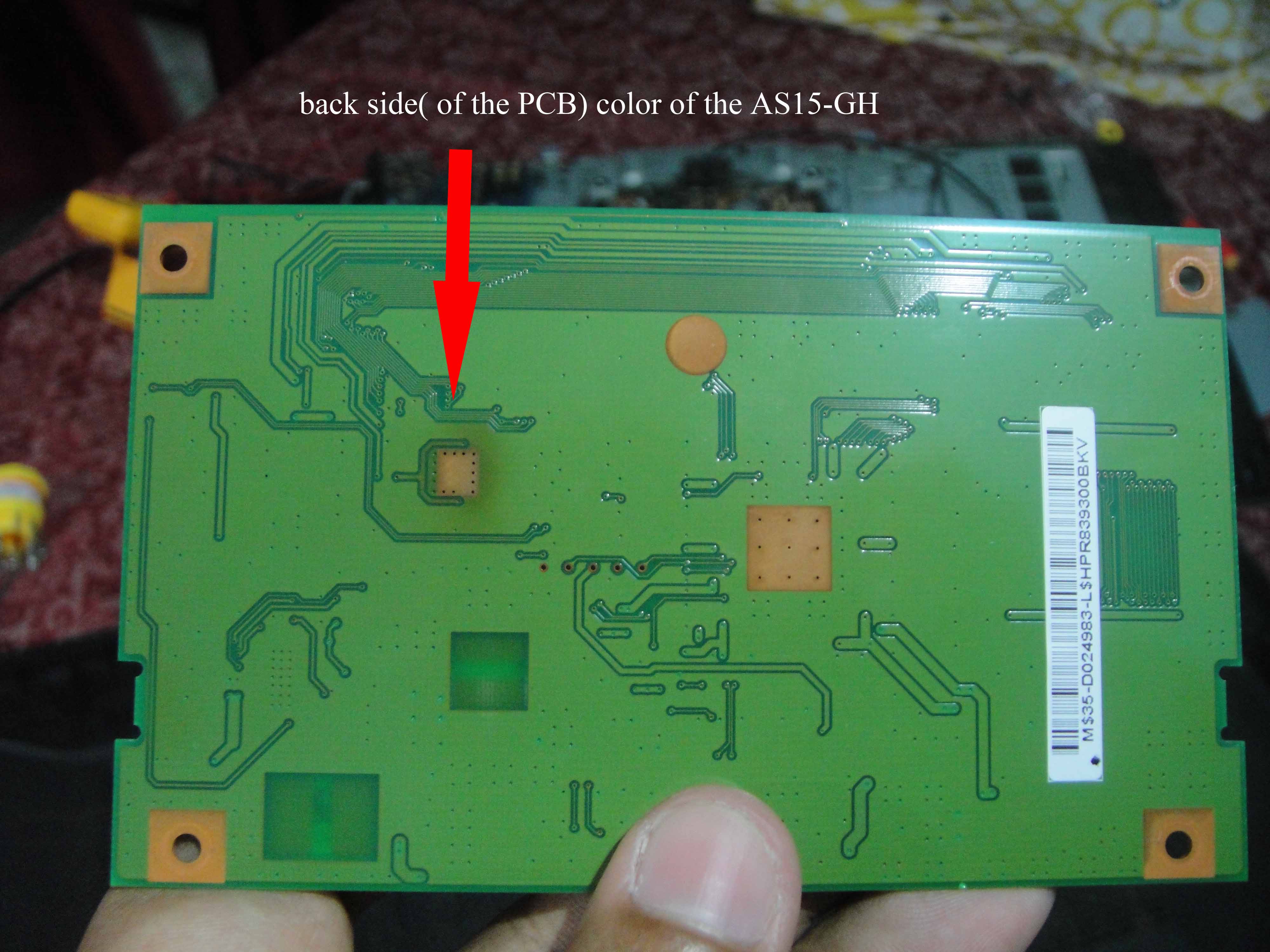

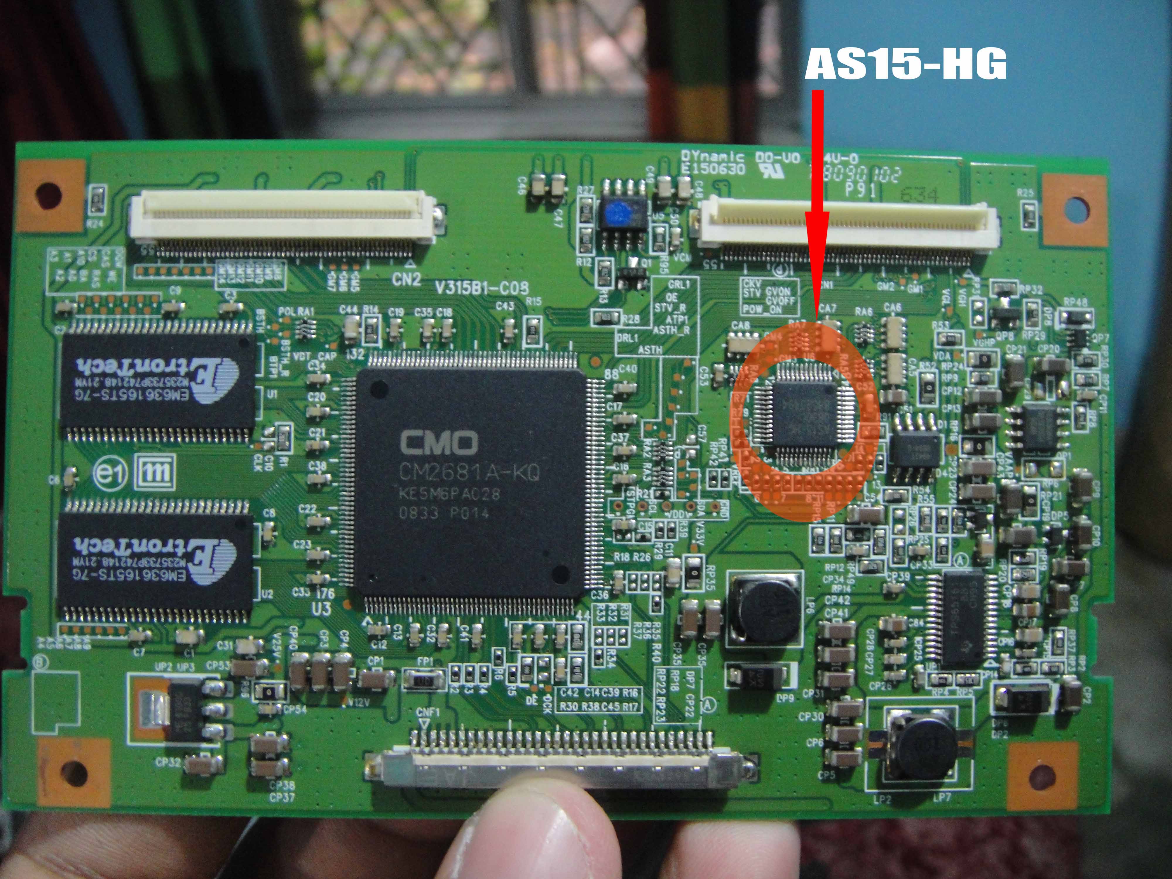

after a long time i have been able to see my TV for 20 mins! what i have found is that a IC named (no.) as AS15-GH is heated up very quickly after turning on the TV....
is that mean the IC, I have to change or have to look further.... need your guide......

Worth a try, if you can source the chip - the TCON board is part of the LCD, so assuming you could find it listed anywhere (and it's NOT a programmable device) it's likely to be in China.

I've no idea, you would need to compare the rise in heat of the chip with a similar working set to see if it's abnormal or not. But if you had a working set you could swap the T-CON board over to make sure it cured it.
Do you have a source for the chip?.
did u ever sort this problem,,, i have the same issue. did you replace the tcon board or just the chip?
I didn't find the chip in our locality, so i called the serviceman from sony and they change the tcon board!!!!!:banghead:
