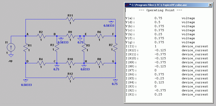

First of all, I promise that I did not Google for the answer. I just solved for the resistance across the diagonal, because the other 2 pair of points are solved the same way. The cube can be drawn as a 2-dimensional mesh. The mesh looks like a 3-step ladder with a resistor on each side. Next I assumed all resistors were one ohm, and a voltage source of one volt was across the diagonal. Then I calculated all the node voltages. That was easier than expected because of the one ohm assumption, making the solution matrix sparse. After knowing all the node voltages, it was easy to calculate the total current leaving the upper diagonal node. As a check, it also matched all the current entering the lower diagonal node. Using the definition of resistance, R = V/I was calculated.
The answer came out to be 5*R/6.

Just have to do this::D
A cube has eight vertices. If I force 1A into vertex A, I can choose one of seven other vertices from which to sink the current. Because of symmetry, there are only three different possible voltages at vertex A, however.
Here is how I solved it seven times, connecting only one ground at a time: R=V(a)/1
The numbers are expressed in terms of R*Ohms
