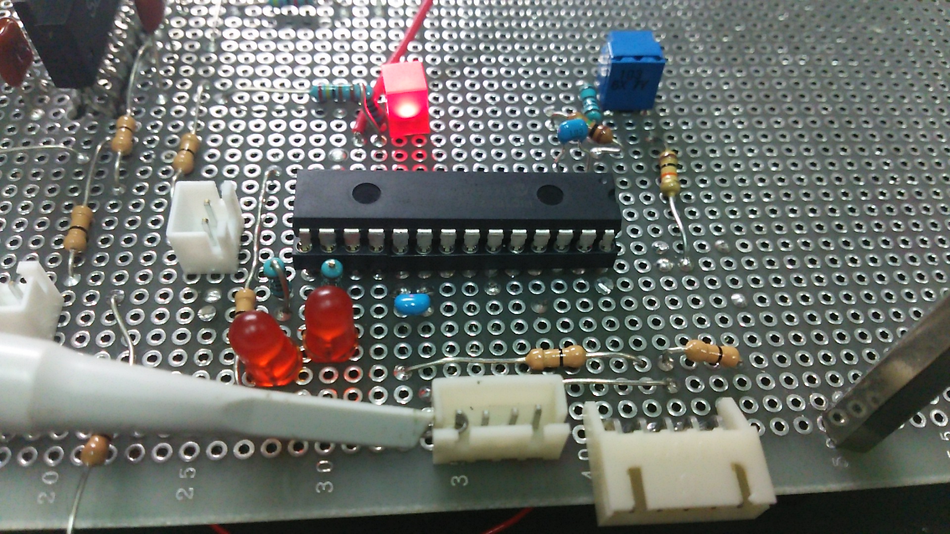

I have soldered a socket to a perfboard, and put a 18F2550 in it. I have also soldered a circuit in it in which I use pin RB0~RB4. I also soldered RB6,7 to connect to the programmer. I have soldered other necessary components.
The program I wrote basically gives 1s or 0s to pins B0 to B4. nothing else.
I have successfully program the PIC.
Then when I power the PIC sometimes it works, sometimes it doesn't. If it works it keeps working good until turn off (there is no instability)
When it doesnt, a small push in the side of the PIC makes it work. Investigating more, when it does not work a touch with a metal to the PIN B5 makes it work. if it is working it makes it not work again!!!
Now I suspect about the soldering. however here is the strange and bewildering fact:
I used a oscilloscope to test the PINs directly.(Not the soldered connections) Pin Vdd is receiving 5V successfully. However Pins B0 to B4 are not outputing anything!
If I touch B5 they start.
So It is not the soldering or the connections!!!
What is happening here? Any idea? really any idea?
I have run out of possible solutions!:banghead:

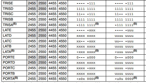

That said, last year I chased such a problem with a 16F1519 for months. Some of the symptoms were the same. I could re-program, and it wouldn't work. If I touched the pins or even let it sit overnight, it would work. Eventually, I found two problems and addressed them. I am not sure which of those problems was the real culprit. One problem was in the initialization of the EUSART module. I had not followed exactly the MC sequence and initialized the baud rate first. The second problem was initialization of RAM, i.e., General Purpose and Common (both were used). I added a small program to clear both in reset. The pin problems you mention may indicate a similar problem or a problem in initialization of your ports. Note that on reset, many of the registers are unknown or unchanged (Table 4-4). Do you have proper pull-up or pull-down resistors in your circuit?

You should program all the unused pins to be outputs or to have pull-ups. The change in behaviour when you touch an unused pin makes me think it is floating.
Thank you very much for you reply.

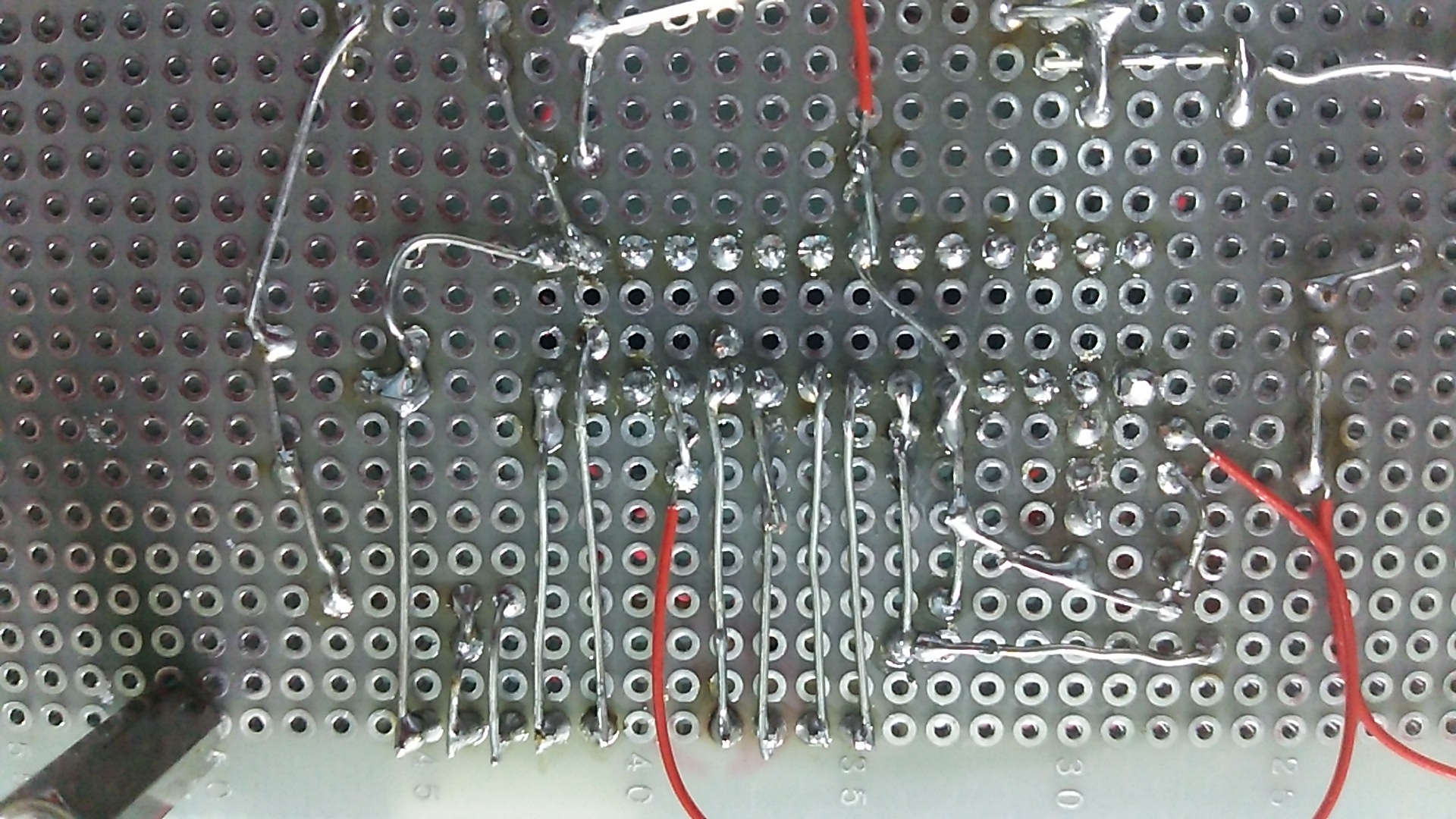

Here are pictures of the soldered PIC. I am a beginner and I have monkey hands :facepalm: so please forgive the uglyness
In the first pic the pin that causes problems is the third lowest to the left (next to the red cable). Right now it is connected to nothing
its TRIS is 0 so now it is configured as output.
