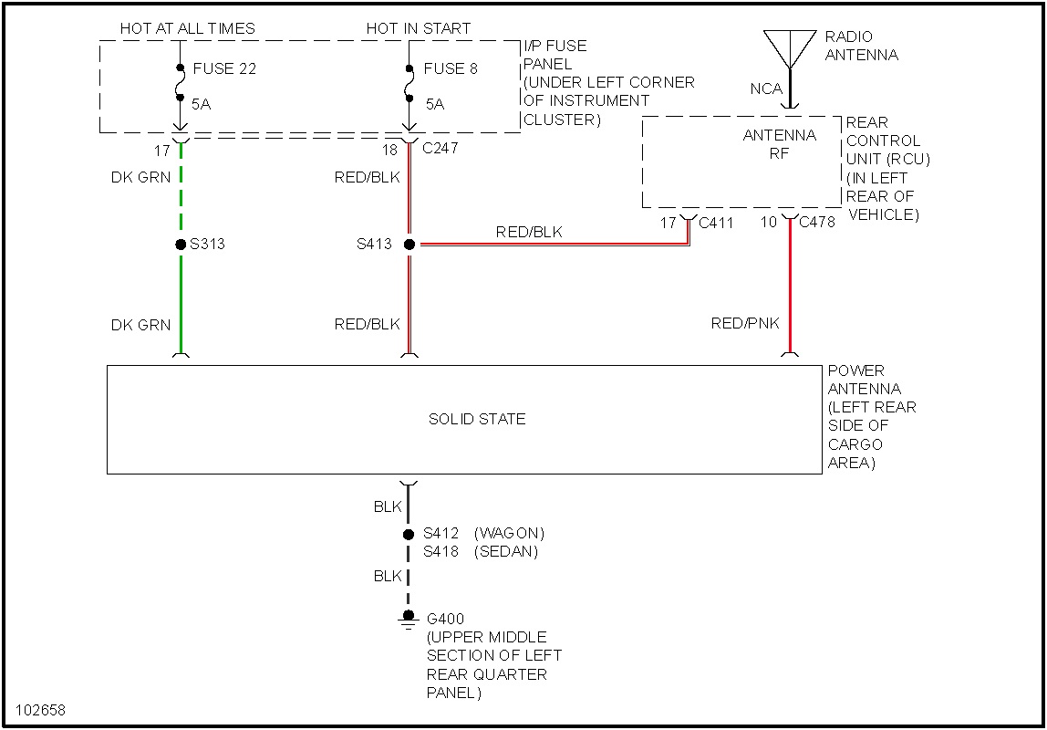

I am utilizing the factory power antenna circuit in my car to act as the remote turn-on wire for my aftermarket amplifiers. I need to keep the factory radio because it is integrated with the climate control, and it would be too much work to integrate an aftermarket deck.
Anyways, the power antenna circuit seems to have no capacity for amperage at all. It is in fact a 12v dc signal according to my multimeter. I also checked how many amps the power antenna itself draws from this wire, and 0.00a registered on the multimeter when switched to DC amps.
I've tried numerous 12V pc style relays with coil resistances from 90 ohms up to 720 ohms. 720 ohms at 12 volts is about 200 milliwatts or 17 milliamps. That little amount of current is still too much for the factory circuit to handle. The relays didn't make a sound when hooked up.
I think Ford designed this circuit to cut mass-production costs. The power antenna module uses some sort of solid state device that reads the signal and raises and lowers the antenna based on when the radio is on or off. Thats exactly what i need to control my amplifiers, except the current capacity just isnt there. Not even using a 700 ohm relay.
I'm not familiar with solid state devices, so maybe you guys can help me.
A schematic of the antenna circuit would be helpful :)
Here ya go :p
As seen in the image, the wire that i'm tapping into would be the red/pink wire.
A ULN2004 https://www.electro-tech-online.com/custompdfs/2013/03/ULN2003.pdf would likely work for you.
It's a bit strange of a chip. It contains 7 relay drivers. The relay would be connected to OUT1 and +12.
The COMMON (Free wheeling) point also gets connected to +12 generally at the relay.
Anytime you use a relay, you should place a diode (so it doesn't conduct) across the coil just like it's shown in the IC diagram. The chip, connects the relay coil to ground.
To make the IC a bit more reliable, it might be a good idea to add a few more parts. A bypass cap, a transorb and a reversed biased diode and a small fuse. The automobile electrical environment is really bad.
You could do a quick test with a LED and resistor for the relay coil and go from there. I can look around to see if I can find an automotive qualified part.

By 12 V signal, you mean it goes to battery voltage when om and near ground when off?
Yes by the 12V signal i'm talking about, the circuit goes 12V when the radio is on, and down to 0V when the radio is switched off.
I looked at the diagram for the ULN2004, and honestly I have no clue how I would hook it up for my application. I'm sure it will work if you guys say it will, so i have confidence in it. Only thing is the wiring.
You would only use one device. Let's call your relay coil pins A & B.
Pin 1 (IN 1) - Goes to the turn on signal
Pin 16 (Out 1) - Goes to Relay Coil Pin A
Pin 8 (GND) - Goes to Ground
Pin 9 - Goes to Relay Coil B
Relay Coil B to +12, fused, like at 1A or so.

A 1N4004 or 1N4003 https://www.electro-tech-online.com/custompdfs/2013/03/ds28002-1.pdf . Note the band on the diode. The band will point to + and the other end will go to ground. This will protect against the polarity being reversed and somewhat negative spike from the ignition system.

Think of power conditioning to be a fuse, a reversed biased diode to ground, an 18V TVS diode or ZNR to ground. This then becomes the power source for your device. Your new, conditioned +12 V.

Take a 12 V supply and fuse it at like 1 amp. then put the cap, diode and TVS in parallel. The diode bands toward +12. Connect the other sides together and to car ground. The idea is if the device should be connected backwards or a surge is way too high, the fuse will blow.
