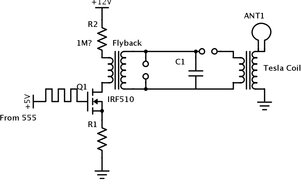

I'm going to embarrass myself, but what can I do to improve this? I watched a tutorial on mosfet oscillators and I came up with this. I actually might use 9 volts input. The 5 volts is from a 555 timer. Does this work, and what should the resistor values be? It's really basic and will obviously need improvement. I just don't want to spend a lot on it.

The above circuit will work, somewhat, but it lacks important protection circuitry. If you run it as shown, there is a strong possibility that you will fry your low-voltage circuitry in an instant. Also, the signal sent from the 555 is very touchy, in order to drive a flyback transformer you'll need a duty cycle of about 20%, which is difficult to do with a simple 555 circuit. I recommend looking up a PWM circuit. I know rmcybernetics.com had a really nice one that I used for a long time that implemented a 555 and a 393 comparator to produce a signal with independent frequency and duty cycle adjustment. That is really what you'll need.
Again, protection circuitry is a must, for example flyback diodes (Schottky diodes are good, though 1N4007s will work as well). Might want an RC snubber too.

Also before going too much farther, you should know that your schematic has an error with the mosfet gate. The mosfet at 5V on the gate will be more of a resistor than a switch. The mosfet you chose needs ~10V to fully turn on.

You'll need a transistor to amplify the signal. You should be able to do this with another transistor (probably not a FET, though).

Or use 12V for the 555 supply. The 555 also drops ~2V between input and output. So a better choice might be the 7555.
