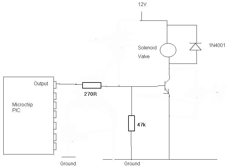

First, I'm REALLY new to electronics. I'm building a project that will run 6 solenoids (only 1 operating at a time). I'll be basing my schematic off the attached diagram, but my solenoids are 12v and have a maximum current of 450mA. The transistors I've got are PNP type (2N3906), rated at 350mW. Would these transistors be sufficient under these conditions? Also, are the ratings on the resistors in the diagram sufficient for my needs? How much leeway is there in the resistance values? For example, I've got 100k, 10k, 1k, and 330 ohm resistors. Would any combination of these be sufficient for what I'm doing?

A few things. You mention a 2N3906 which is a PNP type transistor but only rated at a max current of about 200 mA. Not good! Also in your circuit the transistor is drawn as an NPN. The circuit would be fine as drawn using an NPN. I would use a common 2N2222 transistor (NPN) with your circuit.
Ron
Yes a 2N2222 is good for 800MA. You should look at the speck sheet to get your base resistor. Using combonashoins of your resistors you should get close enough to proto type.
You will need about 45mA of base current to fully saturate the 2N2222 and turn on the solenoid. I believe that is more current than the PIC can supply so you will likely need a Darlington transistor, or two transistor stages, or a logic-level type N-MOSFET to control the solenoid.

Ok, I've got it working with a single solenoid based on the schematic in the first post. Now I've got to scale it up to 6 of them (only 1 operating at a time). I've attached a new schematic (my first schematic!). Can somebody sanity-check it for me? SV is the solenoid valve (12v 450mA).
Apologies for the quality of the image. I'm working with paint here. :)
Edit: Note that 3 solenoids are shown, but you can infer how I'm planning to expand it.
