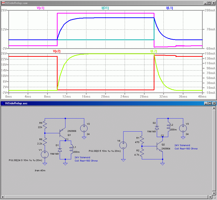

ok, to be a little more clear on my attempts, i have tried to virtually build the following circuit based on the solenoid needing 24vdc and 3.5watts.
in this circuit, i used the tip32a as the transistor and the 1n4001 as the diode. with these components, i determined that i need r1=2.2kohm and r2=22kohm.
when i make this in multisim, i get a simulation error that the program can fix on it's own.
i hope that this makes clear what my attempts have been and where my mistake may be.

Here is your circuit and another. Why do you want to use a high-side driver when the input of a low side driver can be referenced to ground, and be driven with a smaller input voltage?

i have no preference as to whether i use a high or a low side driver (i had to look up what those terms even ment). the schematic i posted was just the only circuit i found that claimed to do what i wanted without buying a tonne of stuff (i'm a student, so my budget is very limited).
i take it you would recommend my going to a low side driver instead? why would that require a smaller input voltage?
Look at my LTSpice sim. Note that the low-side driver is being driven with an active-high 5V signal (like a PIC port). The high-side driver requires an active-low signal that starts at 24V and goes downward from there.
thank you so much, i built your circuit and it works perfectly. i can get almost .5A going through the solenoid.
