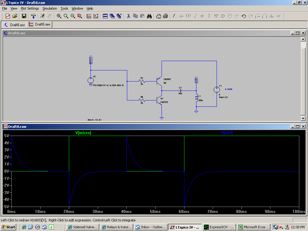

Latching relay
Here is a cheap and dirty driver. If you look around you might be able to find a npn/pnp pair with built in resistors.
If I put a zener diode on either side of each solenoid, wouldn't the diodes consume the voltage required to actuate the desired solenoid too?
