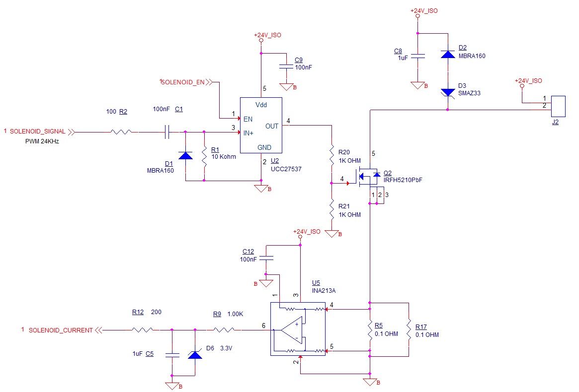

Hello,
I have the below circuit to control a solenoid with a micro-controller.
The solenoid will be drawing about 1.2A and I will also be measuring the current drawn.
My question is with the gate driver for Q2, I think I will need a zener or a divider with maybe 2 1K resistors so I don't blow the gates of Q2 and Q3.
Also on D2, D3, D6, not sure if D6 and D3 and really necessary here. Maybe it would be fine with just D2 as flyback. What's the purpose of D3?

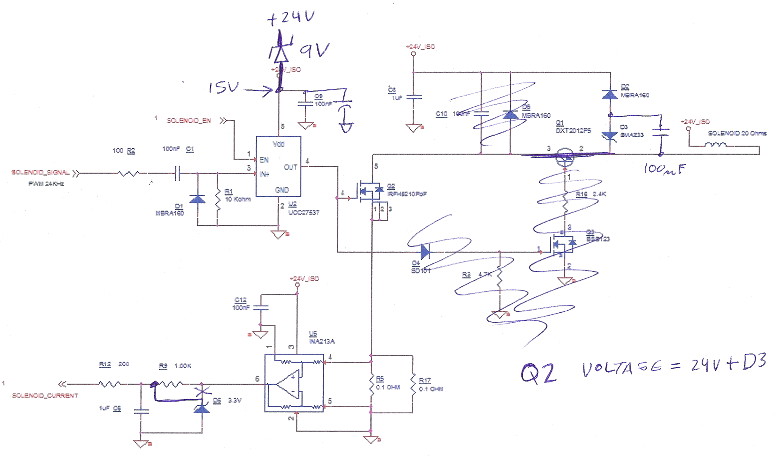

Assumptions: D3 is there so the "valve" operates faster. I put a 0.1uF cap across D3 because Zeners can be slow.
Question: What is D3 voltage? Probably 24V?
Your 3.3V Zener is in the wrong place.
Question: Can the Diff-amp operate from 3.3V? (maybe not)

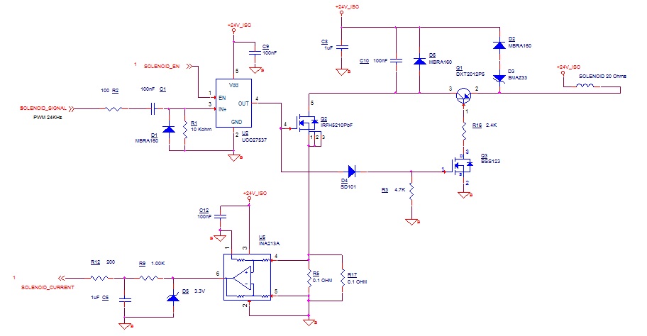

Added a zener to the MOSFET driver supply. Need to bring down the supply voltage. (almost any voltage will work. depends on MOSFET. 10 to 20 volts is good)
MOSFET (when first turned off) will see a voltage of 24V + D3 + 0.7V. So check the voltage rating on MOSFET.

Thanks, this is close to what I was thinking of doing, but instead of a zener on U2 I had a divider at the output to drive the gate.
D3 is 33V and MOSFET is rated for 100V.

If U5 is operating on 3.3V then D6 can be removed.

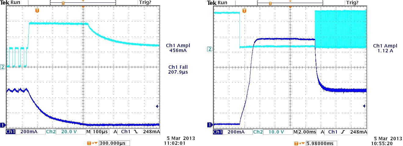

I do not have a datasheet, but I do have some waveforms from some testing I did a while ago.
Ch1 is current though coil and Ch2 is the voltage. You can see the spike at closing time, goes up to about 60V.
Is the reset ~400us, that what you looking for on the closing time?

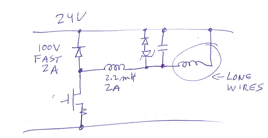

o with a similar circuit to the original I posted.
Putting 24khz sharp edges on the coil will cause RF radiation noise.
This is what I am thinking. After looking at your wave forms, this should work.
Put a non polar 1uF cap on the connector so high frequency noise does not exit.
The MOSFET will be switching between 0 and 24V.
2mH inductor and cap will filter to a voltage at about 12V with ripple.
(if 100% then coil will have 24V)
(if 50% then 12V)
(if 0% then Zener will eat up the stored energy then the voltage will drop back to 0V)

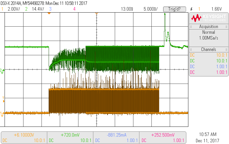

OK so I had already built a PCB with the circuit shown as in the original post and seems to be working on so far.
But my signal is pretty noisy when I connect the solenoid. Ch1 is the PWM output from the micro and Ch1 is at solenoid return.
Not sure why this is so noisy, I added a 100uF cap to the 24V line and that didn't help, seems as if the solenoid return is affecting the entire ground system.
If I remove the solenoid the PWM signals look clean.
