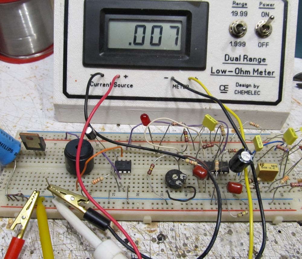

My Test with a LOW OHM METER.
The PIN's are just Two pieces of 22 AWG Tinned Wire.
And this is the Resistance Between TWO Contact Points.

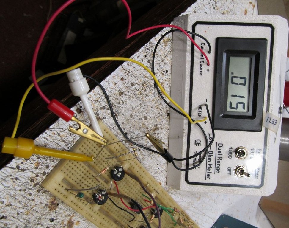

Another Test on Another OLDER Board.
Don't know Why this one shows Sideways?
