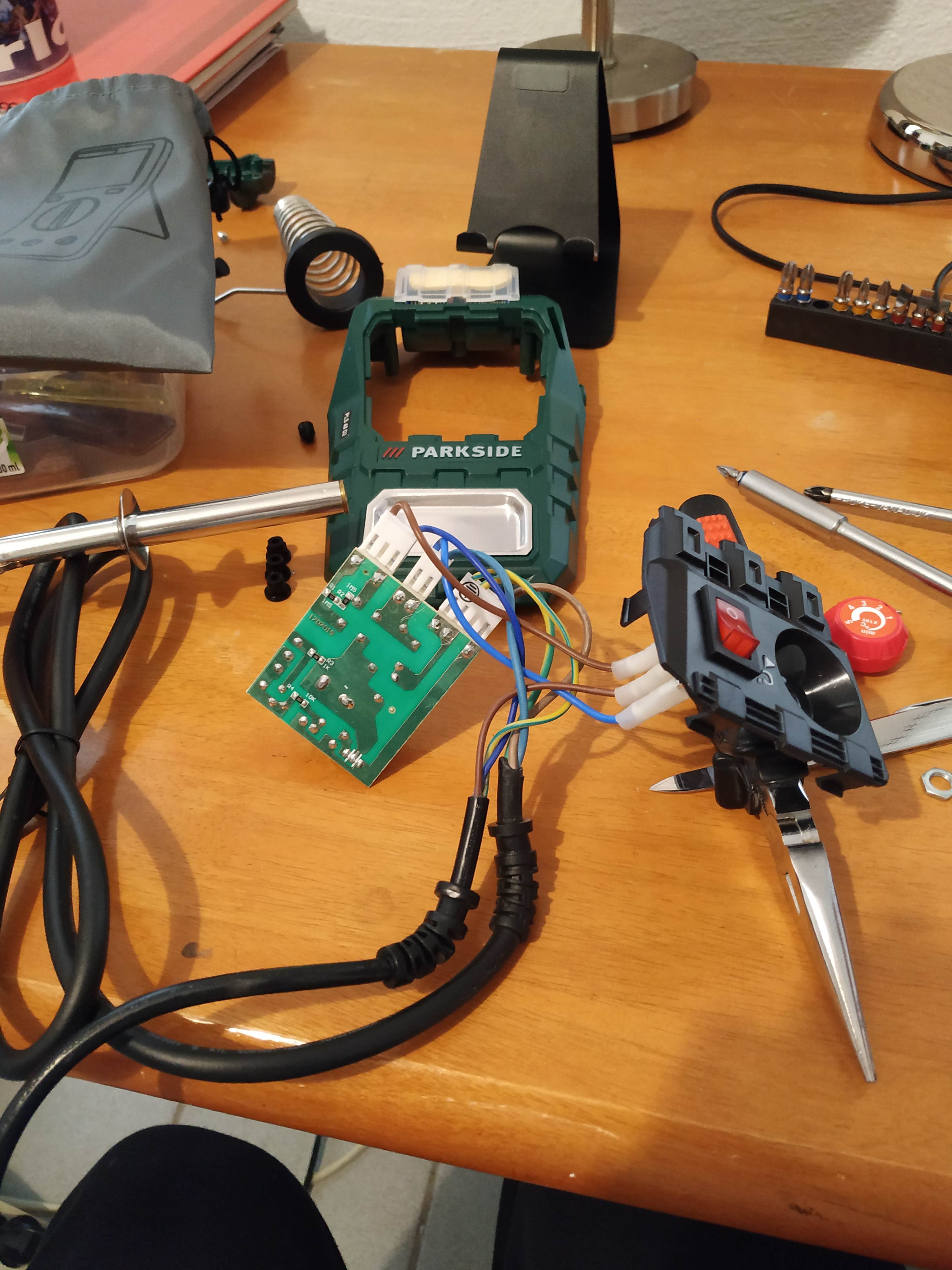

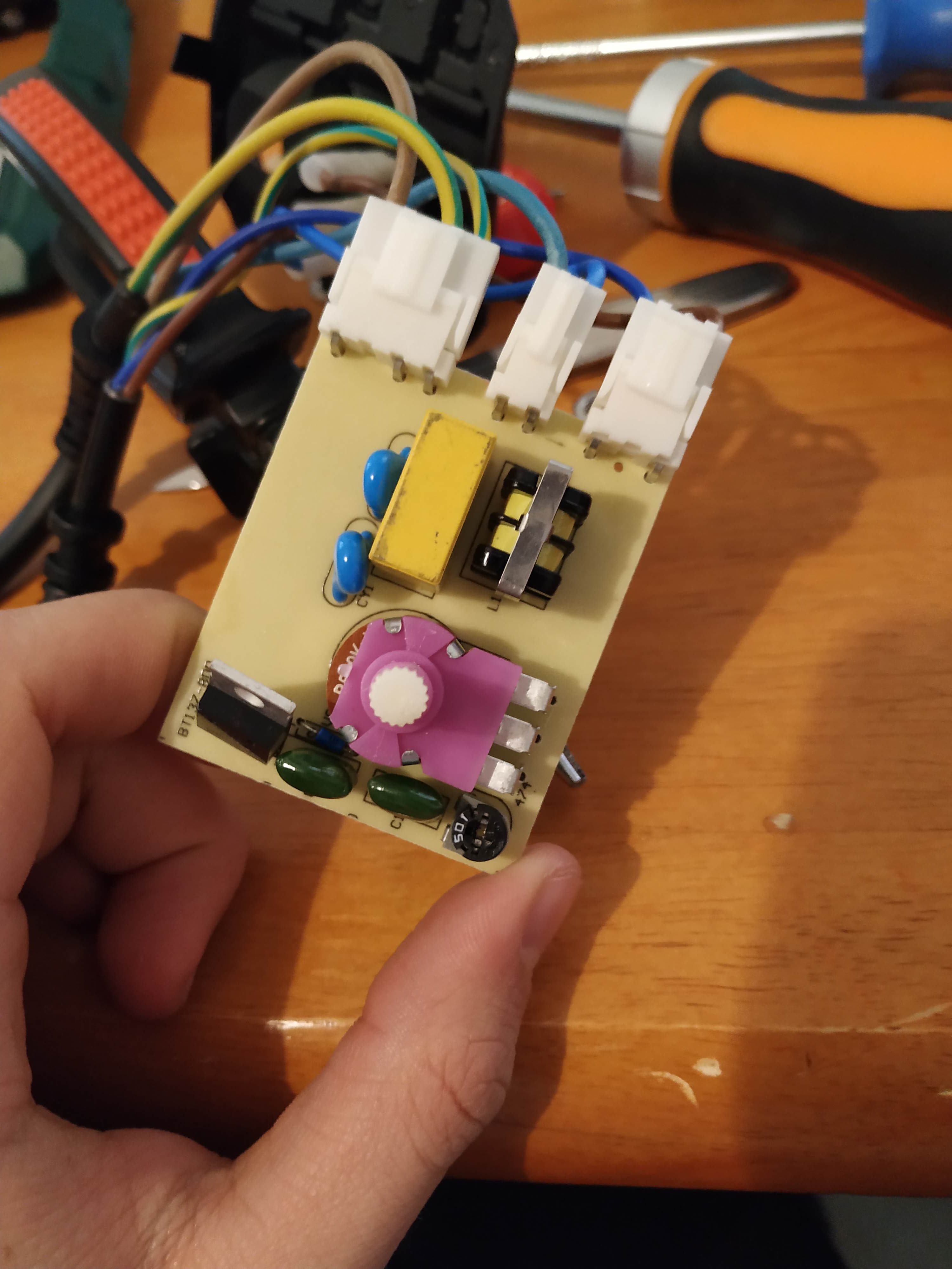

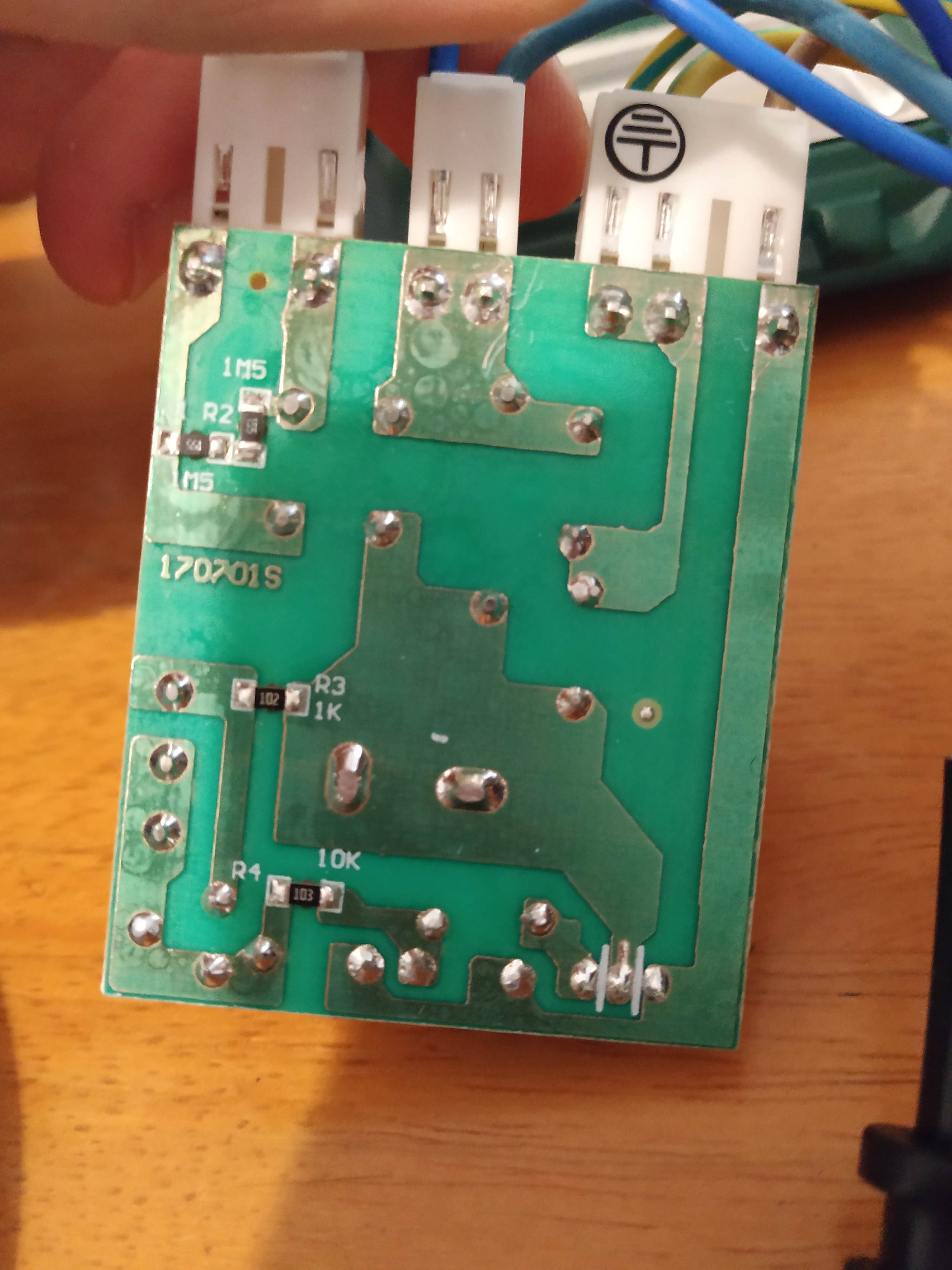

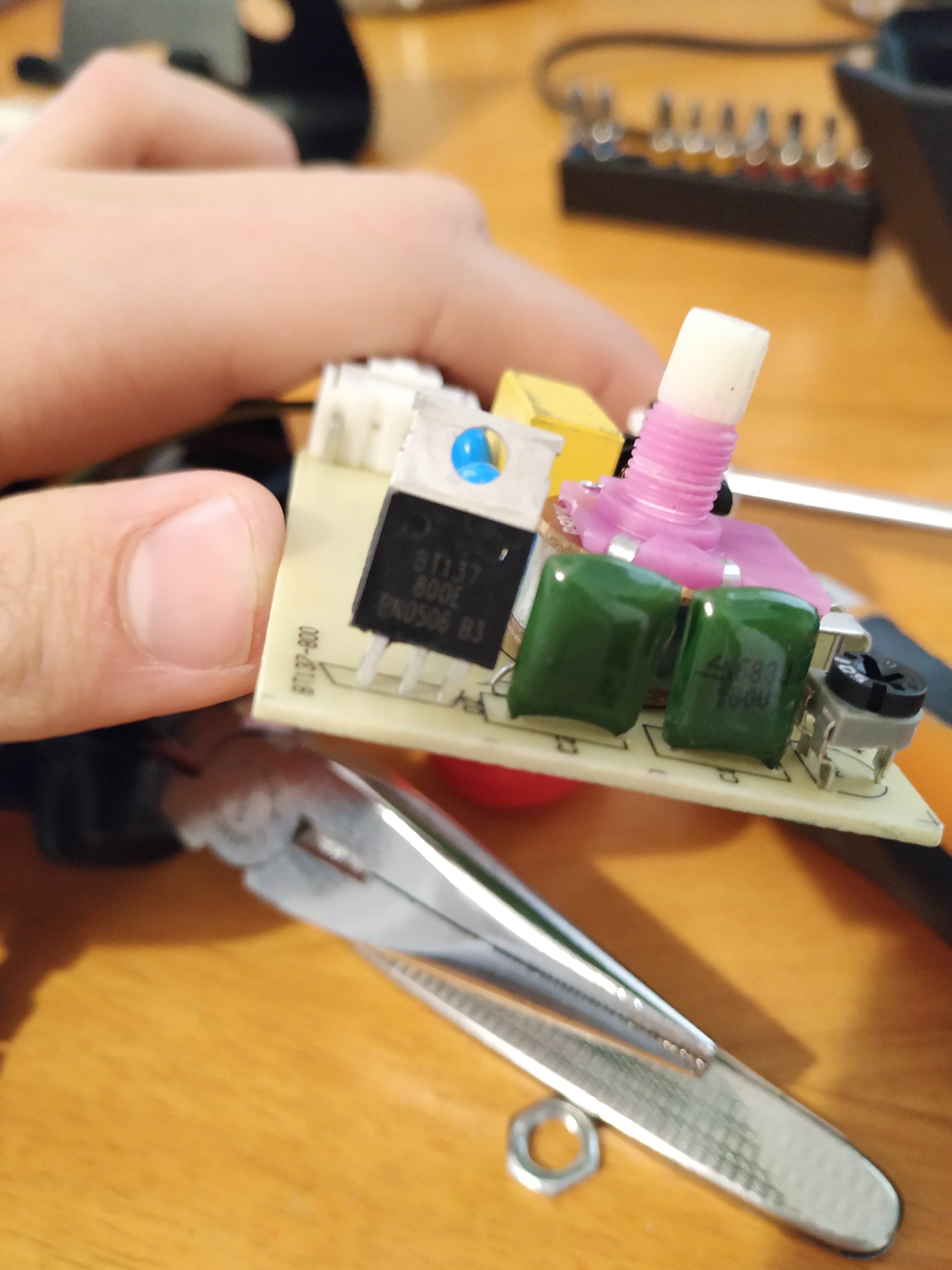

Hello, I recently got a Soldering station to help me with my projects, but it does not work.
I lost the receipt so I can't return it (already tried)
I decided to disassemble it to try and fix the issue.
I get a voltage reading where the power goes into the circuit (220 volt 5 amp) but nothing where the soldering wand is connected, so I'm guessing it's a board issue.
Do you guys have any clue to what could be the issue? None of the electronics seem to be damaged.
Thanks a lot.

Looking at the board and components, it's pretty much a basic diac + triac "light dimmer" design.
Something like this, with minor rearrangements and an added filter inductor:
https://www.dapj.net/halogen-bulb-lamp-dimmer-circuit/
For a total guess, the diac is the most likely failure - they do seem to sometimes have problems at times.
That's the diode-like part behind C2.

It's not really a soldering station, it's just a light dimmer feeding a standard soldering iron, there's no temperature control at all - just a simple power level adjustment.
Just googled it, I see it's from Lidl - that explains it all.

Turns out there was a spotty connection at the connector where the voltage enters the circuit, a quick resolder was all that was needed. Thanks a lot for your help.
