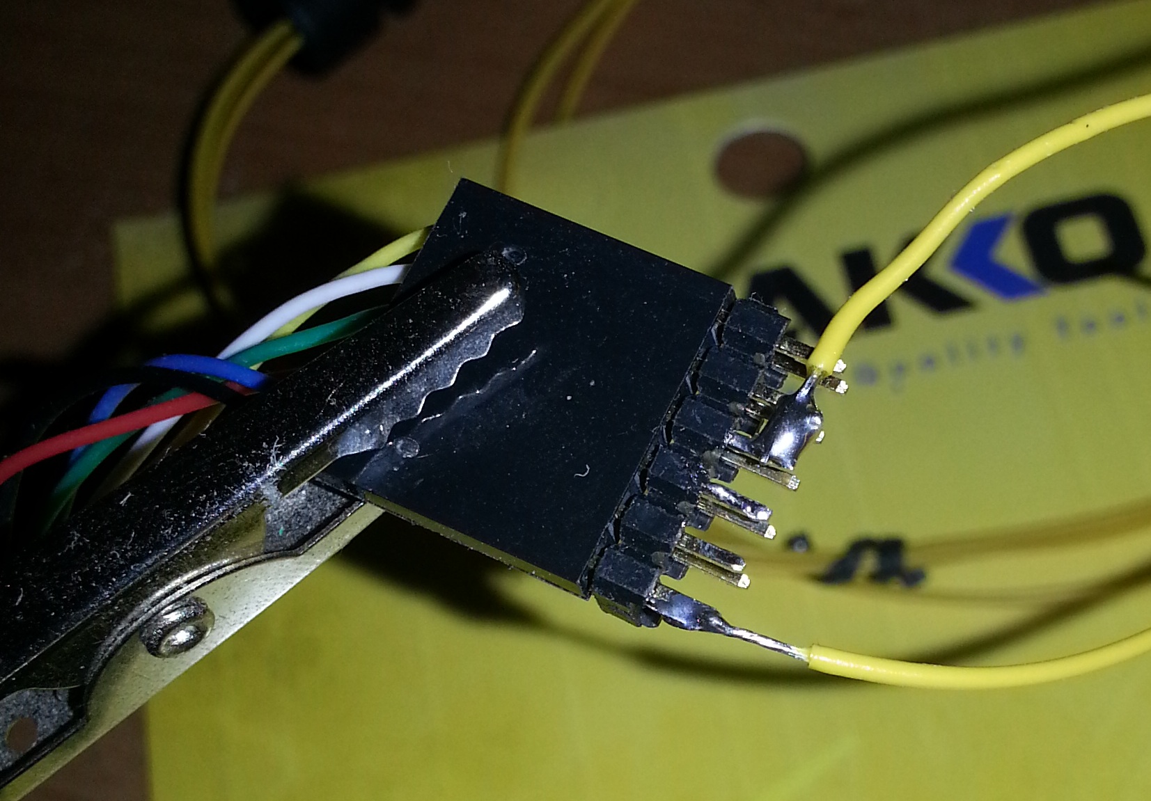

I tried soldering with it just now, here are the results.

Looking at the picture, the joints look acceptable, BUT, the length of bare wire between the solder joint and the insulation is too much, aim for 1 to 1.5 "wire diameters" of bare wire between joint and insulation.
You know, I was actually wondering about that. I will keep this in mind next time. Thank you.

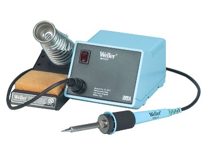

AG, I bought one of those simple Weller 'stations' in 1986. It worked for a few months.
I looked at the replacement prices and discarded the iron.
A few years later I read on the Net that you can often get the iron to work again by banging it on the workbench one or more times. I guess something sticks in the iron.
My Weller soldering iron with regulated temperature was not expensive because it does not have a Mickey Mouse light dimmer circuit in it. It uses the "Curie" theory and simply uses a magnet pulling on a switch. When the tip reaches the required temperature then the magnet becomes non-magnetic and a spring turns off the switch. When the tip cools a little then the magnet pulls the switch and turns it on. I hear it clicking on and off.
That would be the Scrooge system I suppose

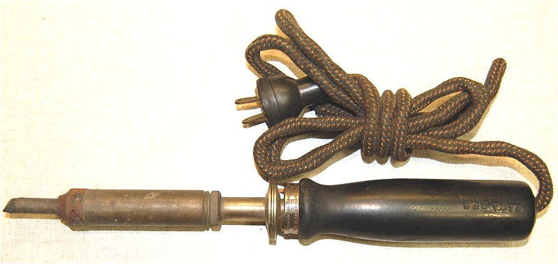

When I was a kid, (~1959) I used an old 100 watt soldering iron.
The iron was heavy and the cord was very light and flexible with a woven covering.
Something like this.
More likely your wiper needed some cleaning or replacement. Over time you can develop poor contact and the banging re-established it temporarily.

Also, as JimB said, it looks like you might have too much bare wire on your connection. If it shorts to another pin it could cause big problems.
Another idea is to angle it out away from the connector rather than parallel to the connector body.
