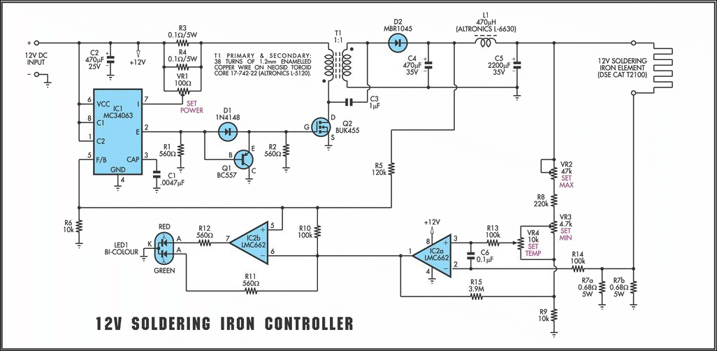

Here is a typical soldering station circuit, from Silicon Chip:

Interesting circuit colin, thanks for posting it. It does look like it suffers from the tip heat capacity delay, but might work good enough for many uses.
It's also interesting that it is using a 12v element. I have one of those around here somewhere i might be able to try this with. My other irons are all 120vac, but would most likely run on 120vdc too.
Thank you Reloadron for the schematic, I never would have found it myself. I'll try to build a light dimmer and a diode version and then decide which one works best for me.
